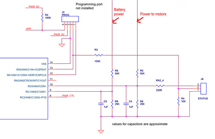

Hey everyone,
Last night I wired our robot and once I had finished I plugged in two batteries and powered the robot. For the first 30 seconds I used our old pragma to control various aspects of the robot with the wrong control (eg. When I pushed drive forward the I take would run). Anyways after this initial 30 seconds the robot power cycled itself and afterwards the power expanded would start to blink red. We tried replacing the battery three times but that still lead to the light immediately flashing red. We tried replacing the power expander twice but both both times it would immediately start to flash red. Does any one have any ideas as to why this is happening? We have tried everything we can think of and we just can’t figure out why this is happening. Thanks!

In your situation it depends on how quickly the LED is blinking. Fast means the breaker was tripped and battery is very low, and slow means the breaker was tripped and battery is normal. Attached below is a table of power expander LED values and what they mean. This was pulled directly from the VEX website, and I’ve also posted that link below if you’re interested in reading it.

If you have the cortex off and then plug in the battery, what does it do?
Is the status port plugged into the cortex? If so, that causes the blinking.
In that case, this seems to be your explanation and solution.

There are two versions of the power expander. The original version was designed to work correctly with the older PIC processor, it had a minor issue when used with the cortex. New power expanders were revised to be more compatible. This change only affected the status port and LED, it did not have any effect on motor performance. This change was made several years ago.
See this (very) old thread for a few more details (mostly made before I understood what was going on).
https://vexforum.com/t/power-expander-status-port/20846/1
VEX can update old (pre rev A2) power expanders to the new spec (which only involves changing an internal component).
