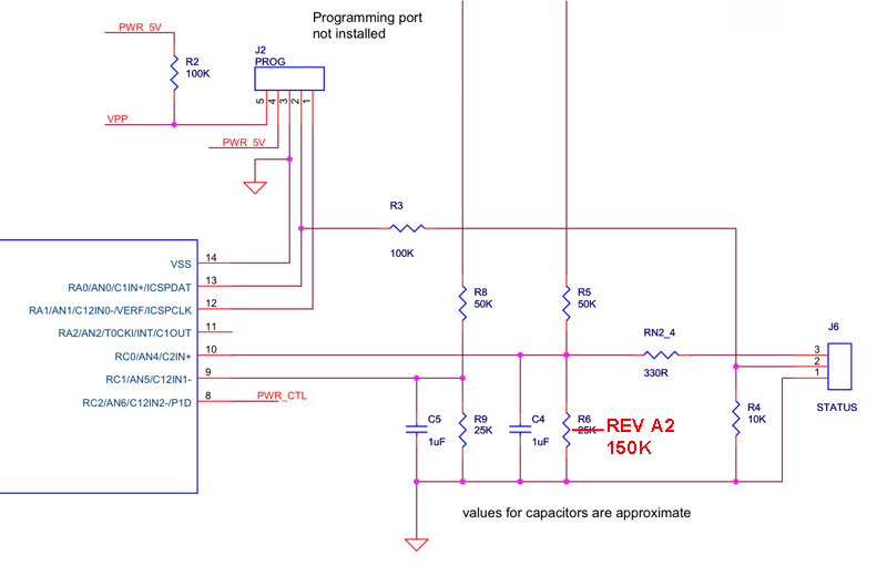

I have at least two, perhaps more, power expanders that when the status port is connected to the cortex the led on the power expander flashes red indicating a blown PTC. Others (here and here) have reported this problem in the past but I thought I would look into why this is happening a little more.

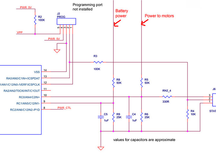

The PIC inside the power converter monitors both input battery voltage and also the voltage at the output connector going to the motors. The way this is done is by first reducing the voltage into a range that the PIC can handle using a potential divider and then converting this to a digital value within the PIC. The (partial) schematic for this is as follows. The full schematic is here, it’s not an official one, just hacked out from observations.
The resistors R5 (50K) and R6 (25K) form a potential divider such that there is approximately 2.5V on pin 10 of the PIC when the battery voltage is 7.5V. This voltage is then fed through a 330 ohm resistor to pin 3 of the status port.
The cortex analog inputs (according to the wiki) have a 10K series resistor and then a 20K pulldown to ground. When the status port of the power expander is connected to the cortex this additional 30K is placed in parallel with R6 (ignoring the 330 ohm series resistor) giving an equivalent resistance of approximately 13600 ohms (there’s also a 470K pullup but we will also ignore that for now), this reduces the voltage on pin 10 to about 1.6V which is presumably the cause of the red flashing LED as it translates to a battery voltage of 4.8V. The wiki also has the conversion factors for converting the power expander status voltage to battery voltage. This is given as Vd / 45.6, where Vd is the digital value read from the analog input (apparently as a 10 bit value). 1.6V on a 10 bit scale is a value of 328 so the calculated voltage is about 7.2V, close enough.

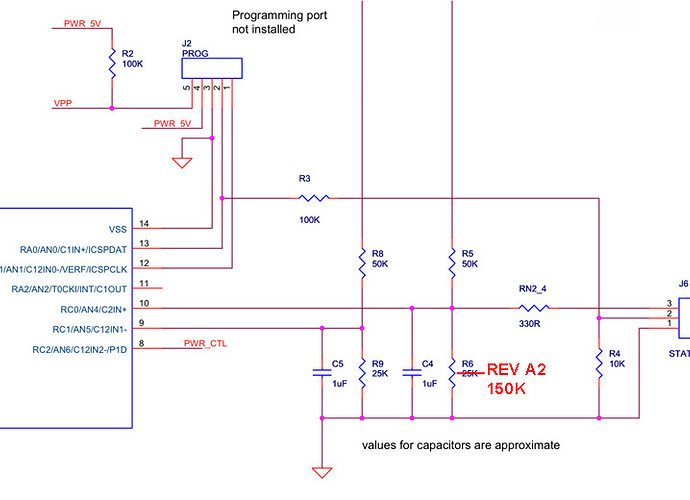

I finally received a “new” version power expander (they were on backorder for weeks) and had a look at the differences. The new one is marked POWER EXPANDER A2 where as the old one was just marked POWER EXPANDER. Plugging the status port into the cortex does not cause the red flashing led issue that the old unit has.
I should add that since the original post the wiki has been updated and says that there are in fact a total of five different versions (no rev, NC1, A, A1 and A2). It also gives revised conversion factors for the new A2 version, although still off by a factor of 4, it should be V = analog value/280 (for ROBOTC anyway).
The difference between the two versions I have is trivial, a change of a single resistor value from 25K to 150K. As far as I can tell there is no change to the firmware (unfortunately the code protection bit is set in the PIC so no firmware downloading), I have tested both and they now behave the same.
My original post noted that the problem was related to the 30K input resistance of the cortex in parallel with the R6 resistor. Now that the value of R6 has been increased to 150K, the additional 30K in parallel gives a combined resistance of 25K (using 1/Rt = 1/R1 + 1/R2), back to the expected value by the software in the power expander.
