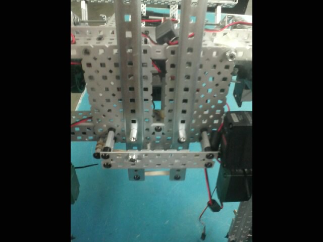

I Dont have pictures right now, but i can certainly get some at engineering tomorrow. Our Robot has a passive anti-tip device, elastic powered, released by lifting the arm. We need to work with the elastics a little because we almost took a teammates finger off test deploying it the first time.
That would be extremely helpful if you wouldn’t mind. Do you have a six-bar? We had a really tough time with tipping at our last competition so I’m looking for a short term solution. We have a solid long term one I’m looking to reveal if we get to worlds :o. But this would be extremely helpful. Thanks!
Due to unfortunate circumstances including a factory defective phone, i wont be able to get any pictures in before tuesday, sorry. I tried to take them with my loaner phone, but it came out looking like an aluminum blob. And even that wont upload to my computer :confused: but yes, we do have a six bar. it needs some work, however, on spacing between bars. but it serves us decently. We finished our final testing on the anti-tip this week, and even placing it in the most vulnerable position (arm raised, front wheels on bump) and pitting our clubs strongest robot against it, it would not tip.
After a quick google search and a bit of creative thinking, i managed to get the pictures on my computer. The Samsung M360 does not allow cable transfer. The picture isnt the best, since to completely view the mechanism you’d have to take it apart. However, i can break it down step by step to explain it.
The first part is two small aluminum plates mounted to the bottom of the chassis with the green plastic slide inserts mounted onto that (one insert on each plate). Mounted via standoffs below the plate is a cut steel rail piece (larger width side is where it’s mounted, if that makes sense((also upside down)) with a hinge mounted onto the same side. the hinge is placed so that it can only swing open one way (the other direction is blocked by the side of the rail, so to properly place it the joint of the hinge must be right by that side) when the hinge hits the side of the rail, it cant open any more. thats lock numero uno.
The actual piece that keeps the robot from tipping back is two linear slide rails that slide on the plastic pieces. for them to lock, you have to screw a nut onto the outside of each one (so the nut then goes past the hinge, then cant go back). then boom! you’re untippable. but how do you keep it in the robot before the start of the match you say?
We have a standoff mounted on pillow blocks under our scoop to do that. the inside end of the slide rails has a cut bar connecting them, and then mounted on standoffs is a L-bar. the l bar catches on the scoop standoffs.An elastic band (or in the beginning for us, about five xD) streches from a standoff mounted on the chassis directly above the mechanism to the standoffs the l-bar is on. then when we raise our arm, and thus our scoop, the l bar is no longer caught on the standoff and it shoots back.
Sorry for the lengthy explanation, Im not too good at summarizing :stuck_out_tongue: I hope this helps though!
