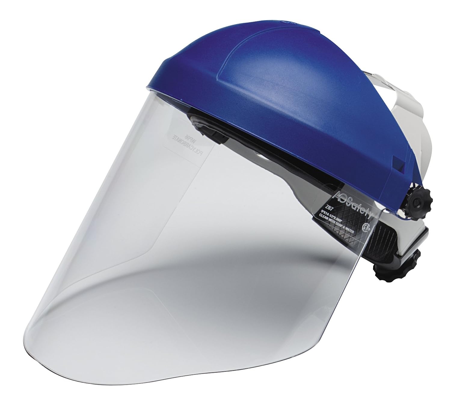

Face Shield
Before we go into power tools, this is a must for the Dremel and grinder. They are wicked cheap so there is absolutely no reason not to have them.
