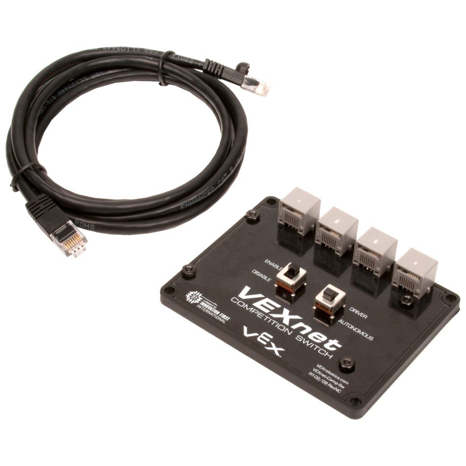

The thread “main” always runs and it is starting two threads “autonomous” and “usercontrol” then it executes the pre_auton function. So main will be running when other threads are running.
The thread “main” starts up and runs whatever code is in it. The thread “autonomous” is only activated when either field control or the competition switch is selecting autonomous and isEnabled==true. The thread “usercontrol” runs if autonomous is not activated and isEnabled==true. See here for how to see this in code. So the only time you will see the function “pre_auton” running from main w/o usercontrol is when the robot is disabled.
If you want to see pre_auton run w/o the other two threads then set the competition switch to “disabled”.
If you don’t want to see pre_auton in driver (usercontrol) then use the link above to see if what mode the robot is in (look at isDriverControl() member function.

do you want pre_auton to run before driver control?
Yeah, I wanted pre_auton to be the first thing run when the program runs. Only after pre_auton is done do I want the program to behave “normally” again. I was just about to say, unless you know of a different way, I figured out if I just base the while loop in the “usercontrol” thread off the variable updated by the pre_auton function I could then activate the program “normally”. Of course if you know a better method that would be nice.
If you plan to use this for competition then leave main and autonomous as is and just wait for pre_auton to be done in usercontrol before doing anything. Hopefully this is what you are doing.
bool pre_auton_done = false;
void pre_auton(vod) {
  //my code
  pre_auton_done = true;
void usercontrol( void ) {
  // wait for pre_auton to complete before running driver code
  while (!pre_auton_done) {
    vex::task::sleep(100);
  while (1) {
   // drive code
Yes that’s exactly what I did. Thanks for the help on understanding the processes though!
