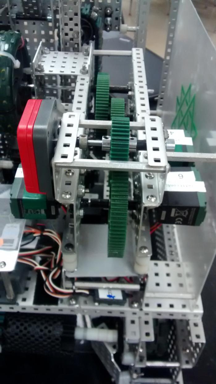

Did you use the gain straight from jpearman’s code? You need to tweak the gain to your system. We ran in to same problem as you in the beginning. What is your sampling speed. We think jitter is an issue with high sampling speed. Where did you attach the encoder to. Is your encoder out of range? TBH will decrease your recovery time, but you can’t feed the system faster than the recovery time. An encoder log will tell you what your recovery time is.

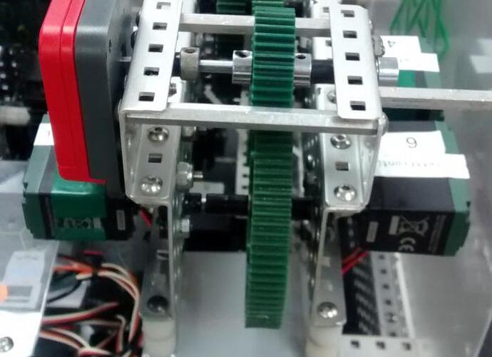

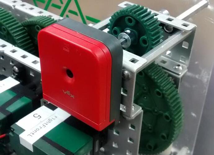

My encoder is geared up a little bit from our slowest gear, as you can see in the attached picture. And no, i have never used the gain straight? could you explain what this is, i have never heard of it! I run it at .55 motor power (70/127) and that puts me at about 200 RPM. After i launch a few balls, it continually raises the motor power higher and higher, and is over-correcting too much. I tried messing with the gain but really have no idea what to set it to?:confused: thanks for any help! (also, i am using turbo motors and i made sure to change that in the code)
