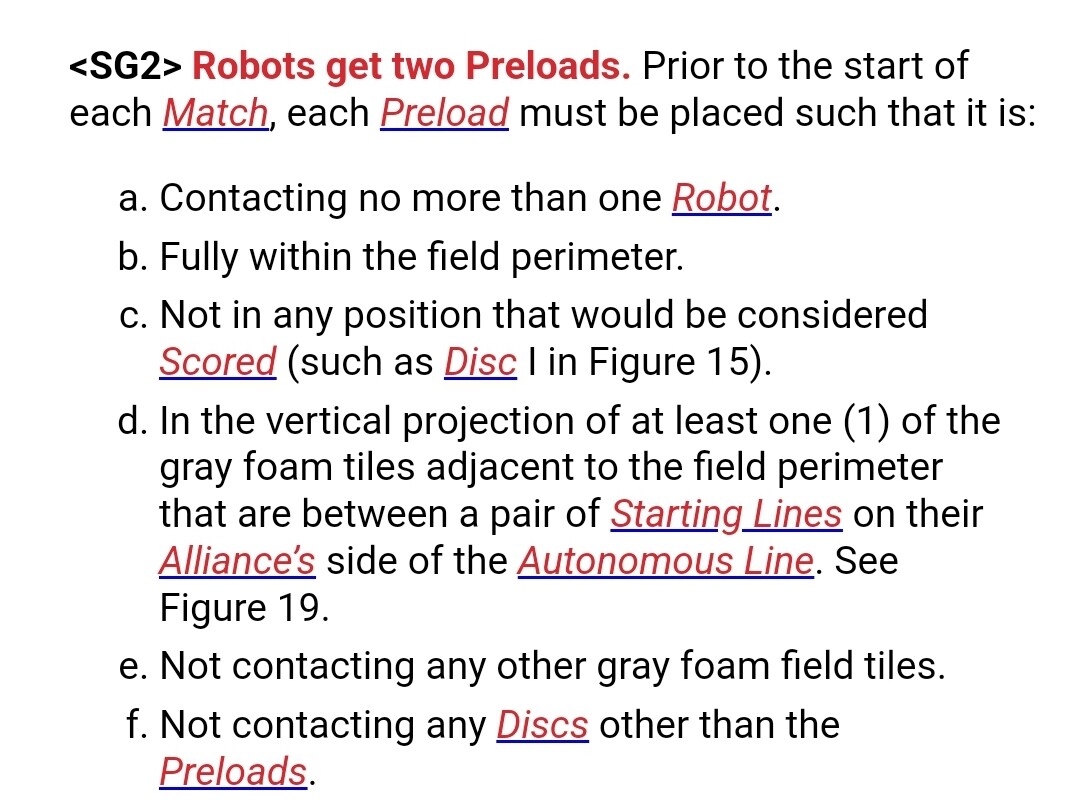

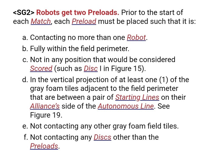

No entirely sure whether you are referring to preloads on match loads but please read the game manual throughly. The relevant rules are SG2 for preloads and SG5 for match loads.

For preload, it must touch your robot before the auto starts

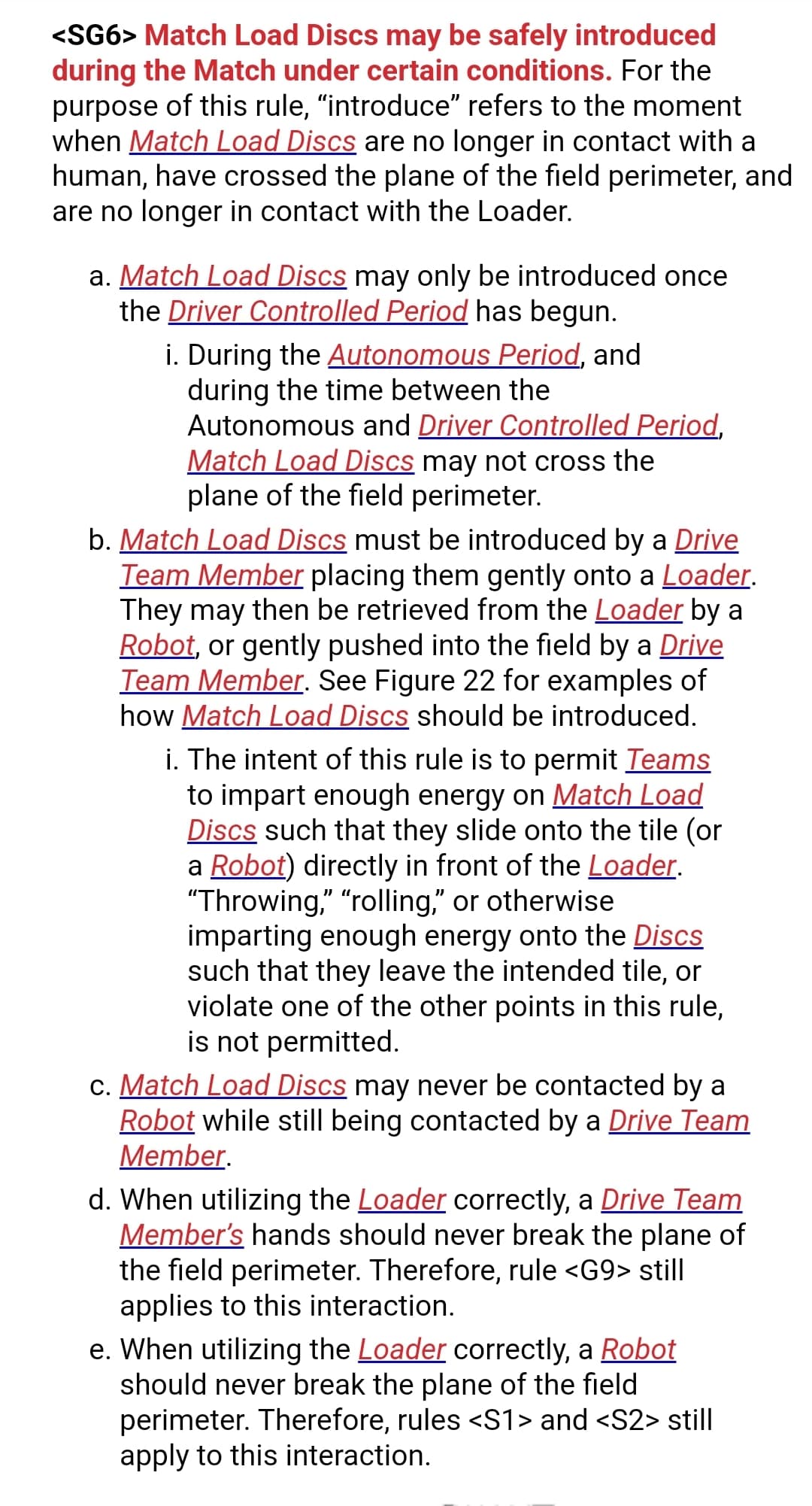

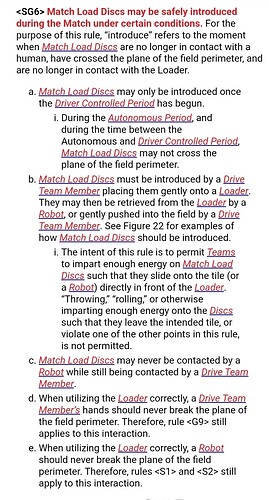

According to screen shot post above showing rule SG6(a), it says ‘Match Load Discs may only be introduced once the driver controlled period has begun’.
For the autonomous period:
Preloads = Yes
Match Loads = No
