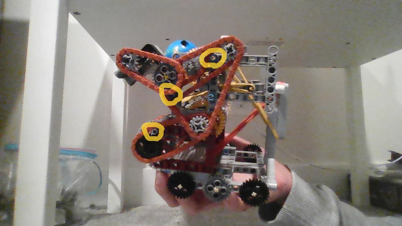

Inside the yellow circles are tensioners I used for the chain in my LEGO Push Back prototype. You could do something similar by having a free-spinning gear of spacer rub against the chain to tighten the chain if it is loose. If your chain is too tight, add a sprocket and adjust the tension so it is not as tight.
