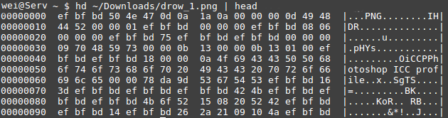

What format is the image? When I unpack “drow_1.png” it is not an ordinary PNG file:
hdpng
Couldn’t open it with viewer or gimp.
Looks like something got messed up with the PNG. The header is supposed to be hex 89, then “PNG”, but hex 89 somehow got replaced with “ef bf bd”, which is a substitute replacement character in UTF-8. This pattern also reappears a few other times. My best guess is that someone opened this image in a text editor and saved it… Can never really know for sure though.
I’ll check, perhaps VEXcode export messed it up. The original had been resized in PS on a Mac.
here’s the project with “uncorrupted” DRow image files, who knew DRow was corruptible…
(and I will replace the original as well)
V5_ImageDemo.zip (331.5 KB)
