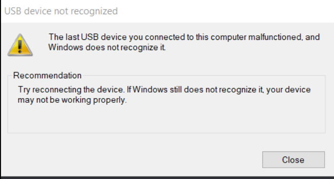

Hey yall. So in my project I was printing to my terminal and nothing was showing up. I created a new project and tested again and still nothing was showing up. My partner copy pasted the code and it didnt work for him eitherHere’s my test code:

I don’t see any issues with your code. Is it possible that your micro usb cable is messed up?
Maybe? I got this message when I repluggled it in:image
So my teammate and I both uploaded wirelessley while the bot was charging. And our brains froze up. Rebooted the Brain and it worked
