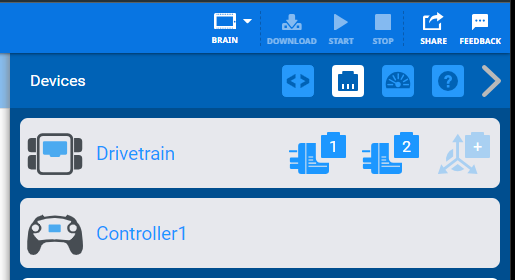

Are you asking how to program this in blocks? All of the print blocks have a dropdown that lets the programmer pick available displays.
In my example the devices are setup as follows:

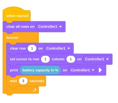

The following blocks are used to display information:
I would also recommend putting your display code in a separate when started because the display cannot respond to changes as fast as the processor can make them.

As I didnt compete this year things may have changed, but the way I used to do it in vexcode is clear all rows on controller to get rid of the standard display, and then you should have 4-5 lines you can print in.
3 lines
how many lines if you don’t clear the brain? because I know my builder likes to know at least how much battery is left
If you don’t clear the controller, you still have 1 line under all the standard info. With that being said, you can still see how much battery is left after being cleared by printing your battery capacity on the controller.
