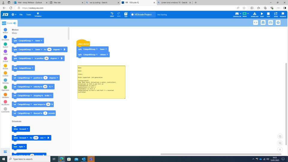

Hello,
I’ve set up the swish robot using the template in vex coding. The catapult works perfectly with the controller, however when I use the two coding blocks lower and release sequentially nothing happens. If I use the blocks one at a time then the catapult works. I’ve tried all the block variations I can think of and nothing seems to be provide a solution. Please see below for the setup. Any ideas would be really appreciated…thanks

Apologies, I meant to send code too. I think I have a solution by using the wait command after the lower block, at least this causes the catapult to release.

I can’t see it very clearly, but you should just be pushing the launcher down, and then spinning it a little bit forward, then it should release due to the tension of the rubber band.
Hello @Andy_Wallace . Since you are putting them sequentially, that means that the catapult is spinning down 1 degree , then releasing .
The fix is pretty simple, just use a rest block in between or just using the spin # of degrees/
