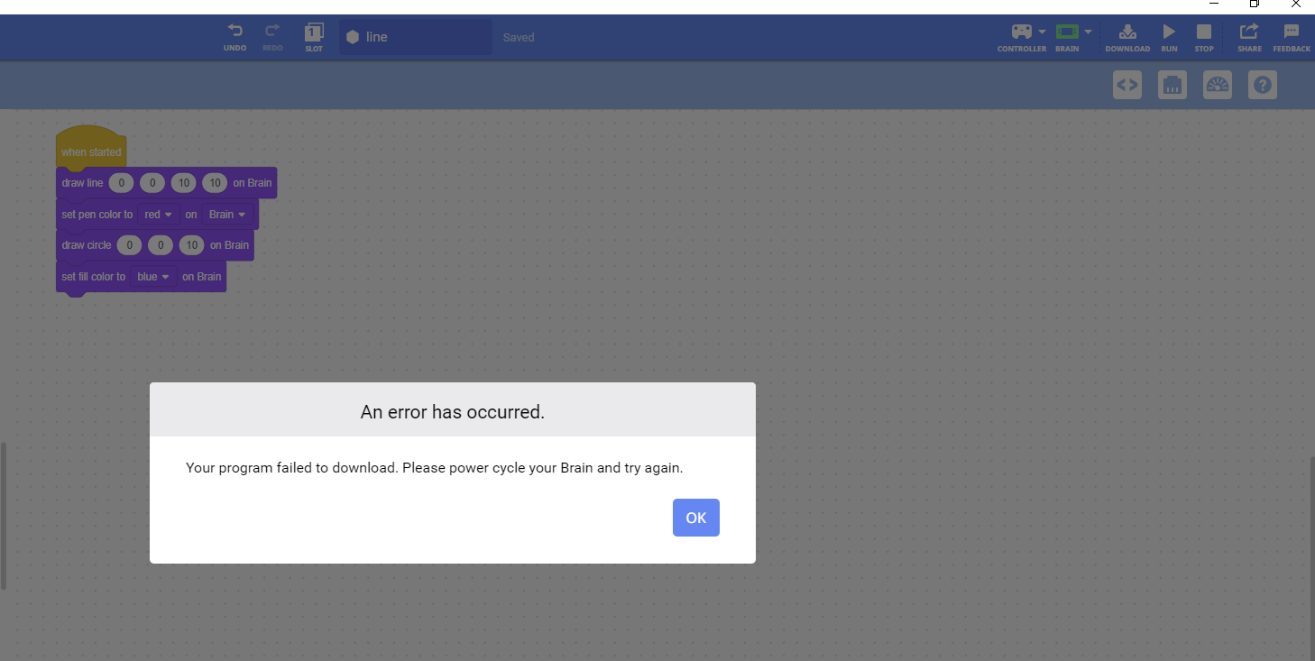

Problem downloading code to Gen2 Brain
Brand new gen2 kit cannot sync code from PC or Max.
Vex IQ software ide does recognize brain and shows as green but sync always fails with download error.

It would be most helpful to send feedback within VEXcode after the error occurs so we can assist in troubleshooting the issue. The individual screenshot does not provide enough context to see what the issue might be.

I have already emailed support multiple times with detailed screenshots and also used Feedback button within VEXIQ app to send error log to VEX.
but its quite disappointing that I dont see any reply from vex for last week and cant get the code to sync from PC or MAC to GEN2 brain.
I am a programmer myself just new to the vex platform. please let us know next steps to be able to sync code and I can try and get back if it helps.

Hi, has any solution been found to these problems? We’re trying to download code from the computer (Windows) to the brain, and we never get a green light in the IDE.
Is the Brain being detected in Windows Decice Manager under Ports (COM and LPT)?
If not are there any unknown devices showing in there?
