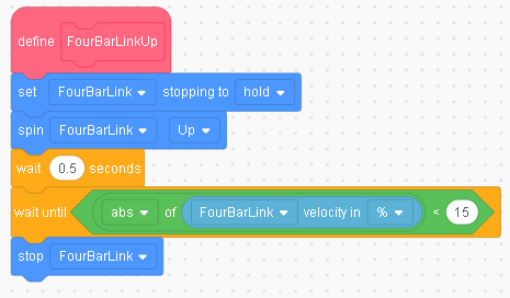

Not to hijack this thread, but we seem to be having the same issue where our 4-bar link arm performance degrades with time - it takes longer for the arm (with a cube) to come all the way up, and the motor starts feeling warm to the touch. I’ll post pics later tonight, but the motor is connected to a 12-tooth gear which in turn is connected to a 36-tooth gear connected to the arm. Here’s a snippet of the code we use to raise the arm to its highest position:
The velocity is set to 70% and the torque is set to 100% elsewhere in the program.
Manually moving the arm up and down, we don’t feel any excessive friction. Can’t comment on torque/weight, since it’s our first mechanism.
Any clues?
