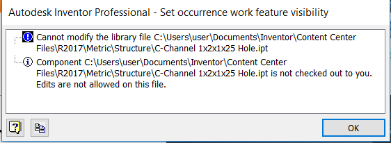

I did the 1st one that you mentioned, however, this pop up showed up after i click show all surfaces
thank you for replying
It sounds like because you have your part files located in Content Center (and based on your current settings related to that), you can’t edit the part files.
The error message mentions that you have not checked out the file (are you using Autodesk Vault?), I believe I’ve seen a “Check Out” button on the My Home page in Inventor. So I would try opening the part file directly via My Home and seeing if you get an option to check out the file, which should let you edit it. Unfortunately, my team uses a system based off of Google Drive to sync our Inventor models, so I don’t really know much about your specific setup.

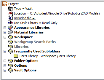

I did some googling and it sounds like this may be an issue with your project file settings. Basically, every assembly or part you create in Inventor has to have a project file associated with it that configures some general settings like the libraries you use and the paths of common parts files you use. So you need to edit your project settings to remove your parts folder from being designated as a library (instructions on how to do this).
What I do with the project is create a project that resides in the top folder of where the CAD models for my team are stored. Then, I added our parts library under Frequently Used Subfolders.
I’ve attached a screenshot of my project file for reference. The reason it’s a Vault project is not because we use Autodesk Vault, but because I am almost certain that if project type is Single User, you’ll get an error if you edit the project on a different computer because the username is typically part of the file path (unless you save the model somewhere where that’s not the case).
