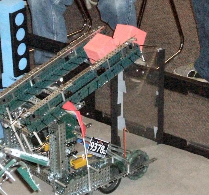

The problem in my bot is that the arm is bouncing and i don’t know how to stop it from doing that. I am using rubber bands as a counterforce to all the weight the lift system has. Right now i think i should use the rubber tubing Vex supplies because it doesn’t have that much rebound as rubber bands.

Right Now i am using a long axle to connect to the gears.Basically we have the Metal Pinion gear running the high strength 60 tooth gear. This is the only pic i have right now because my bot is at school.

From the picture posted it looks like you could be getting flex in your axel. More gears side by side would help with any gear lash and i see you have gears with holes in them. Make some plates on your arm that you can attach bolts that run through the holes in the gears. This will help dramticly.

When the bot is moving the arm bounces up and down thus causing the arm to lower down. What i have see is that the gears a space to move which causes the arm to move up and down. Right now the top gears are connected to each other by an axle. This may cause the bending your talking about.
Right now i have a 5:1 ratio should i increase?
If the arm is backdriving using a higher ratio will help. An easier solotion that you might want to try first is adding more latex tubing/ rubber bands. Not sure if that will work though.
Are the gears actually going away from each other, so they don’t always mesh while moving? If so, you’ll have to strengthen the axles themselves, or support the gears more with more bearing blocks closer to the gears. You also have to make sure that you did not position the gears diagonally from each other, because i have noticed that there is extra space which makes it easier for the gears to bend and stop meshing.
It may also be possible to support your gears by putting another gear on the opposite side of the gears that are moving away from each other to support it and hold it in place. This support gear doesn’t have to drive anything, it’s simply there to add stability.
