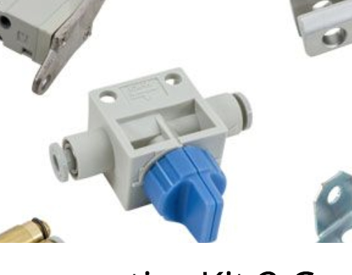

We can consider adding something in 1.0.14 to mitigate this, but that may not be available before the end of this season. perhaps consider just creating a small program to set 3wire to digital output that you can run to keep the pistons activated or install an air valve.

We do not provide a way to downgrade. I’m actually surprised that the difference between an analog input and digital input is enough to cause the solenoid driver an issue, but as I said, they are notorious for being temperamental. I’ll do some tests this weekend and try and see what may be going on. Do you have an air valve you can install between the tanks and solenoids ?
Yes we do but I think we would just shut down the brain to prevent the air leak since we have more than 1 solenoid so adding all would be too many. Thanks for providing solutions!!!
ok, usually the value is used near the tank, but I understand if the routing of your air lines make installation difficult.
