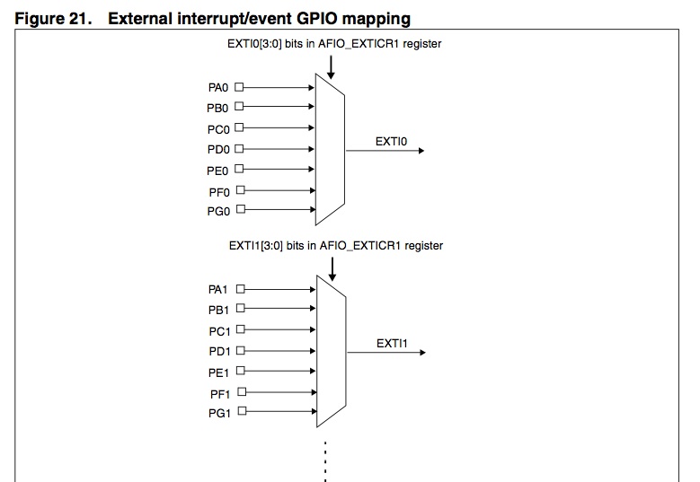

The problem is with the interrupt structure of the cortex. This diagram shows how external interrupts are setup.
PA0, PA1 etc. are the external IO pins on the cortex, you can see that a single interrupt can be generated from one of the seven possible inputs to the mux. EXTI0 can be one of PA0, PB0 etc.
Digital 4 on the cortex corresponds to PC7, digital 10 corresponds to PE7, this means that they can not both be selected as an external interrupt source. No other digital inputs have this issue.
Some types of sensor need interrupts, specifically quad encoders and (probably) sonar inputs. Other types of sensor like switches and leds do not. So there is (and again I stress I have never found time to test this) potentially an issue if you try and use that type of sensor on both digital 4 and digital 10.

You cannot use the quad encoders & sonar (any 2 wire sensors) on digital port 10 because of what JPearson said. You can however use singe wire digital sensors like the touch & limit switches on that port. I wasn’t aware of digital port 4.

Just to be clear, you don’t need to avoid both, only one or the other. So if you have the encoder in say 3&4, don’t try and use 10 for another encoder.
