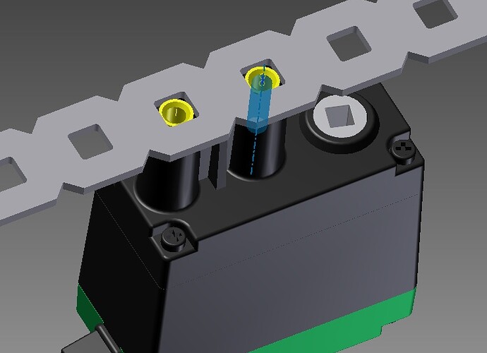

Hello all, just coming to see if you can help me out with an issue i’ve been having with my CAD mockups…
The main problem is certain parts not allowing more than one constraint active at a time. The two parts i’ve noticed so far having this issue are the 393 Motor, without the wire, and the standard delrin bearing. I’ve been getting around this with suppressing the other constraints, but this is a bit time consuming.

Can you elaborate a bit, how are you trying to constrain?
For motors I use three constraints. A mate constraint between between the center motor post and the surface the motor is being connected to. Two constraints between the axis in the center of each motor post and work axis in the center of the (usually square) holes that the motor is being attached to.
Here’s an example, it’s hard top see what’s going on but this is the second constraint between two axis. There may be a better way to do this but I’ve found three constraints are nearly always needed to properly constrain parts.

  I'll try some more with using the work axes. The way i was doing it was just eye balling it with a mate and a flush to the sides of a chassis rail and the motor, after mating the motor post and the surface.
  This might just be me, but when i was constraining the bearings the "lazy" way, just eyeballing it, I could only have one constrain editable at a time, while with other parts I could have as many as I wanted (Screws/Standoffs mainly)
  The tangents will also be something to try, thanks AndrewRemmers. Oh, and thanks again MindstormsManiac, but just a quick question on it-With the chassis rails what are the dots surrounding it for?
You cannot constrain the sides of the motor using a flush to the chassis as they are not perpendicular to the base. Look at the motor from the end and you will see the housing is not rectangular but has a slight angle to it. Do the constraint using the two work axis, it takes just a few seconds to do it this way.
The dots that are not on the actual faces of the part were made when I created the Sketches on the parts. Just ignore them, or you could try to get rid of them if you wanted. They serve no purpose, really.

Jpear, i tried using the constraint to an axis and it worked perfectly! (for the motor) I would assume it might work much of the same way with a bearing, although i haven’t worked with it. it’s just three constraints, first a mate to the metal and then through the axes. (which were easy to create thanks to the drawings on the face of the metal pieces :D)
