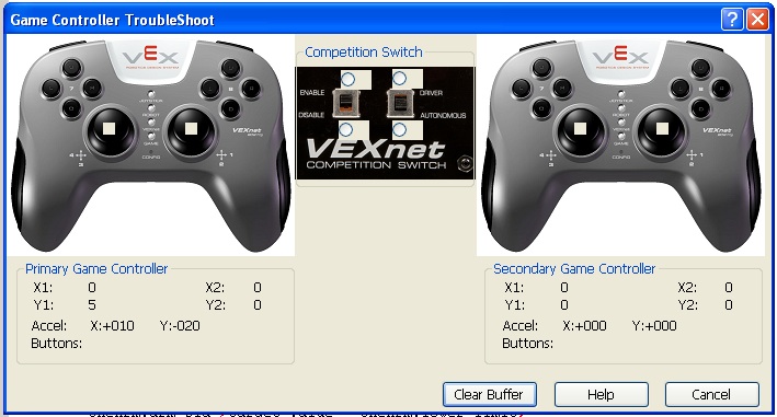

Where can I find the Joystick debug window?
What’s the difference between "else"s, and "else if"s. I noticed your code used elses a lot more than else ifs
You don’t need brackets if it’s only one statement that follows.
An “else if” is sort of like a line of backups. If the first if statement doesn’t work, then it’ll go on to the next else if. If that one is also false, then it’ll go to the next else if, etc. You use else at the end if there are no more conditions to be checked and all other possibilities not checked in the if and else ifs resolve to false.
Ah ok. So use If as an intro, Else ifs like body paragraphs, and Else as a conclusion. Thanks:)
Forgot to mention: We first tethered the controls incorrectly, but we fixed it before the thread was made. We originally tethered the joysticks together then tethered the main joystick to the robot. However, we changed tether to vexnet. We do know vexnet works well on our robot.
Ill give you guys an update on monday
Under the Advanced Tools menu
[ATTACH]7758[/ATTACH]
It then shows this window.
[ATTACH]7759[/ATTACH]
You can see now raw joystick data.
