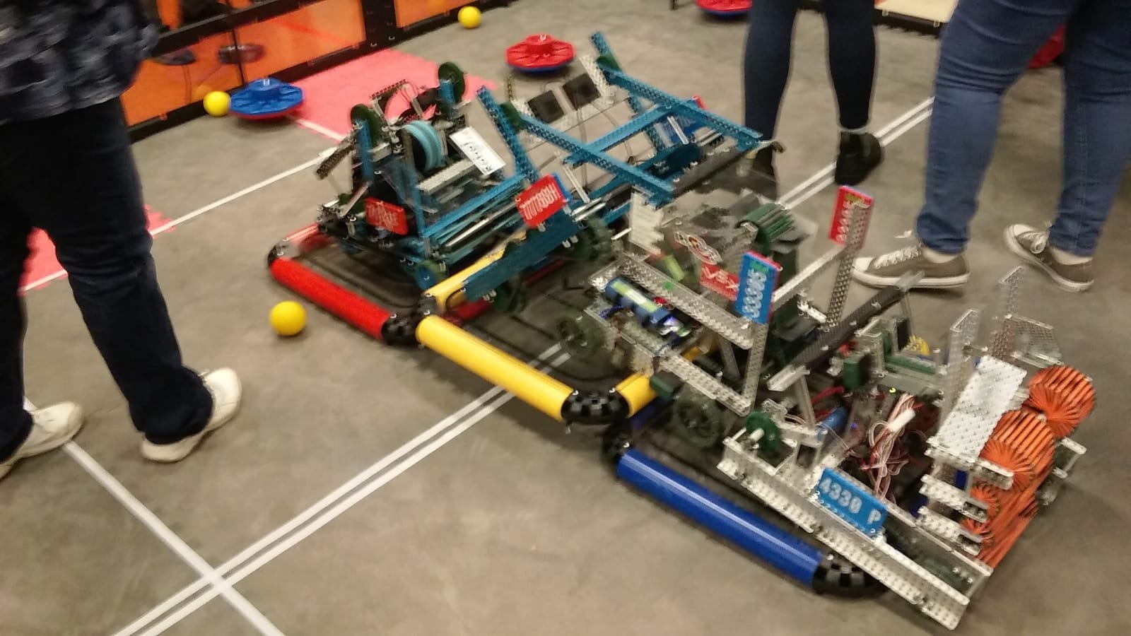

Our robot has this problem where when we try to get on the platforms the bottom of the base hits the platforms and prevents us from getting up. we have narrowed this down to a weight issue because it was working fine before we attached the intake and launcher to our robot. I will try to get pictures and videos up ASAP. Thanks.

The robot on the right is ours. it is technically on the platform because it is off the tiles.four%20robots%20parked

Looks to me like you are bottoming out on the platform. You need to raise your wheel off the ground a bit more.
when we tried that, we mounted it as close to the wheel as we could and it seemed to just act as a wall
We are of the ground, a paper can slide under it without touching the robot
Key words here:
You are not touching the ground, yes, but the main structure of your robot is resting on the platform. When this happens it pulls one set of wheels off the ground and the other set does have enough traction alone to pull/push the robot the rest of the way up.
