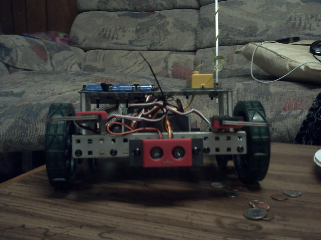

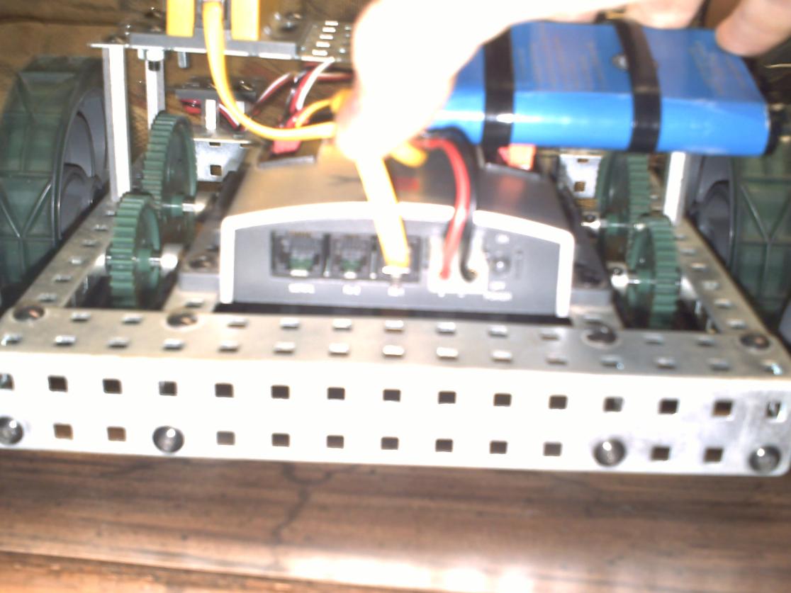

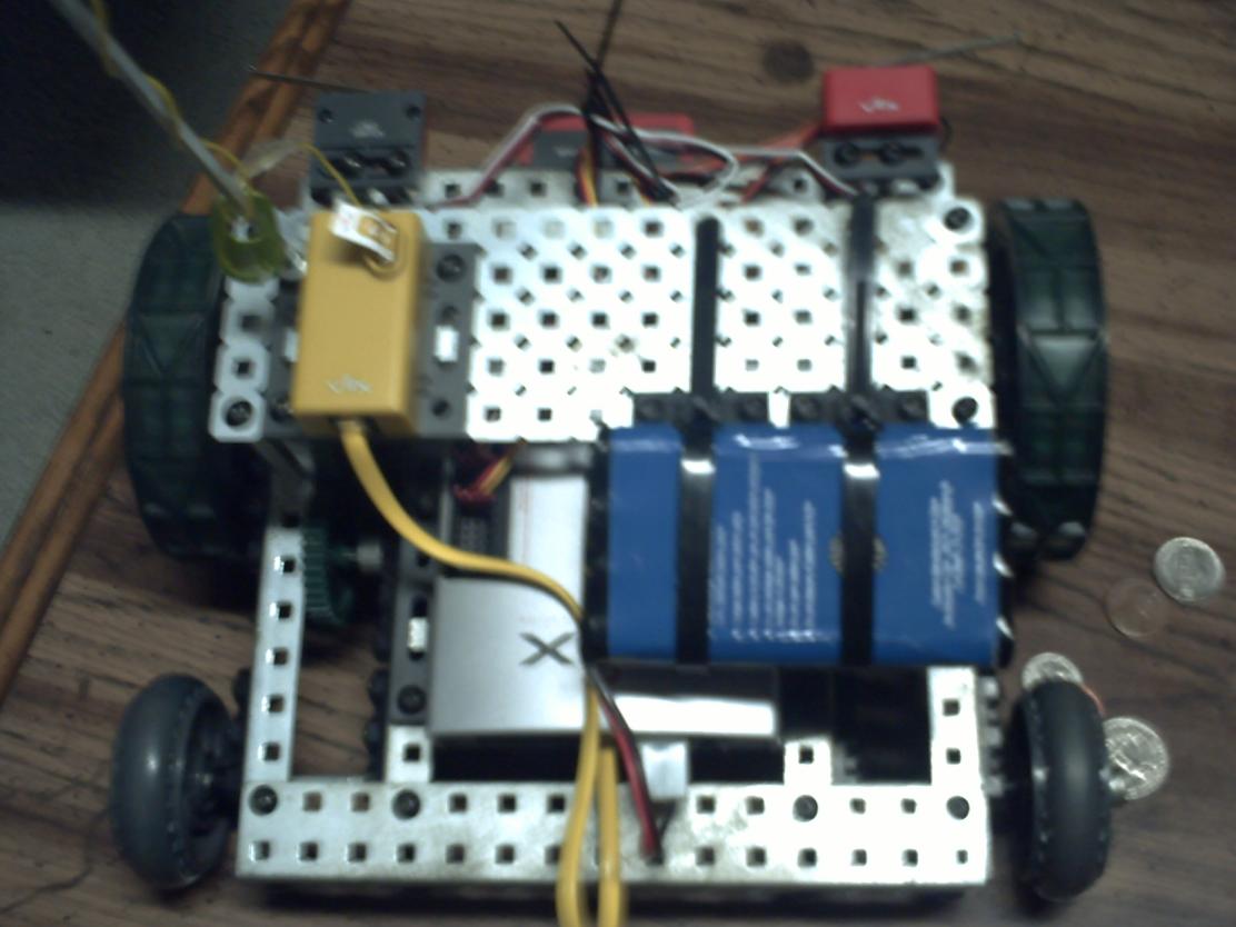

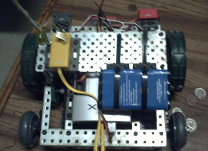

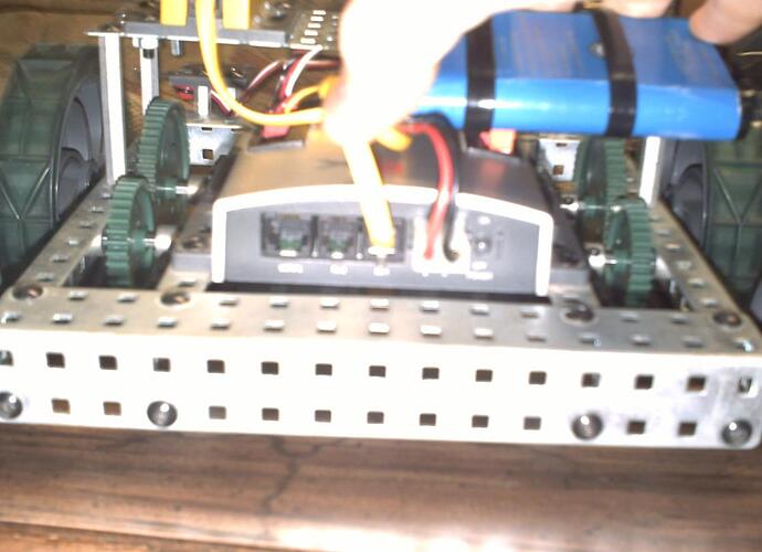

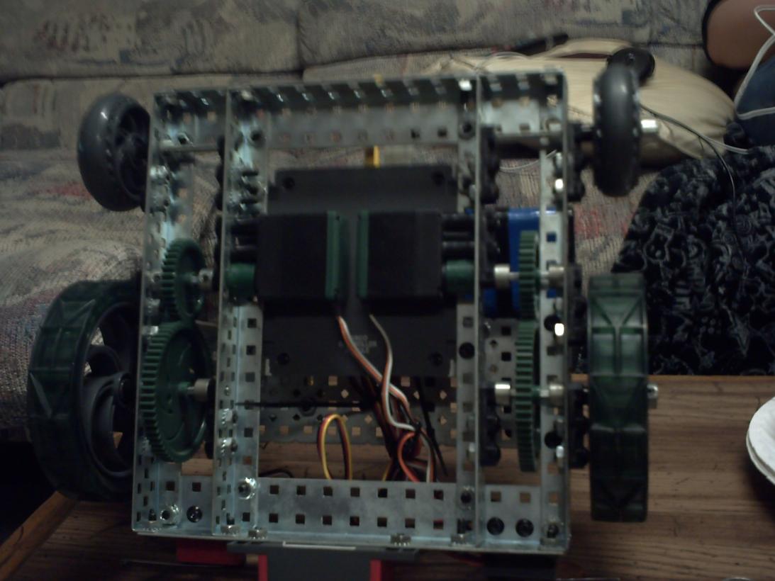

ya the what i want to do is for the bot to turn around and avoid obstacles using the ultrasonic sensor to avoid and the limit switches to help the u.s sensor avoid stuff like cardboard or a blanket that deadens ultrasonic sound so ya the lay out of my bot is a basic box bot ill attach some pictures to show you i got the receiver in Rx 1 and the jumper switch in interrupt pt 5 for autonomous mode and for the RC control in 6 on the controller i want the controls to be on 3 for the left a 2 for the right and if all at possible or a key on the remote to activate the avoid code possible channel 5 or 6 on the controller thank you very munch i appreciate the help.

Yes, that is the Basic Square Bot…
Remember that the Orange Jumper in Interrupt 5, ONLY Executes the Autonomous Code and the Orange Jumper in Interrupt 6 the ONLY Executes OperatorControl Code. After either of the Time Periods is done, the Robot will stop.
