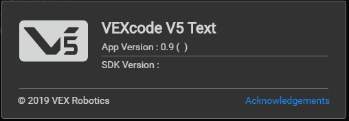

I downloaded VEXcode v5 text, but when it opens and I go to create my first project in it, I can name it, but then when I click the create button, it does nothing. I can not even open any of the example projects because it asks me to create a project. I have tried to reinstall it and restart my computer, but I am met with the same issue each time. It gives no errors on startup or when I try to create a project, but does not seem to register that I click the create button. Has anyone else ran into this issue or fixed it?

Im on windows, trying to use the 0.9 text version
When VEXcode loads, it doesn’t show a version number and the SDK Version is empty. I verified that MS Visual C++ 2017 Redistributable v14.16.27027.1 is installed.
can you copy the contents of the file found at this location called server.log into this thread.
(replace “yourname” with your PC user name
C:\Users\yourname\AppData\Local\VEXcode V5 Text\User Data\Default\logs
