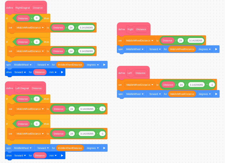

Here is an example if you want a Custom block solution. (and are using 24" wheels)
