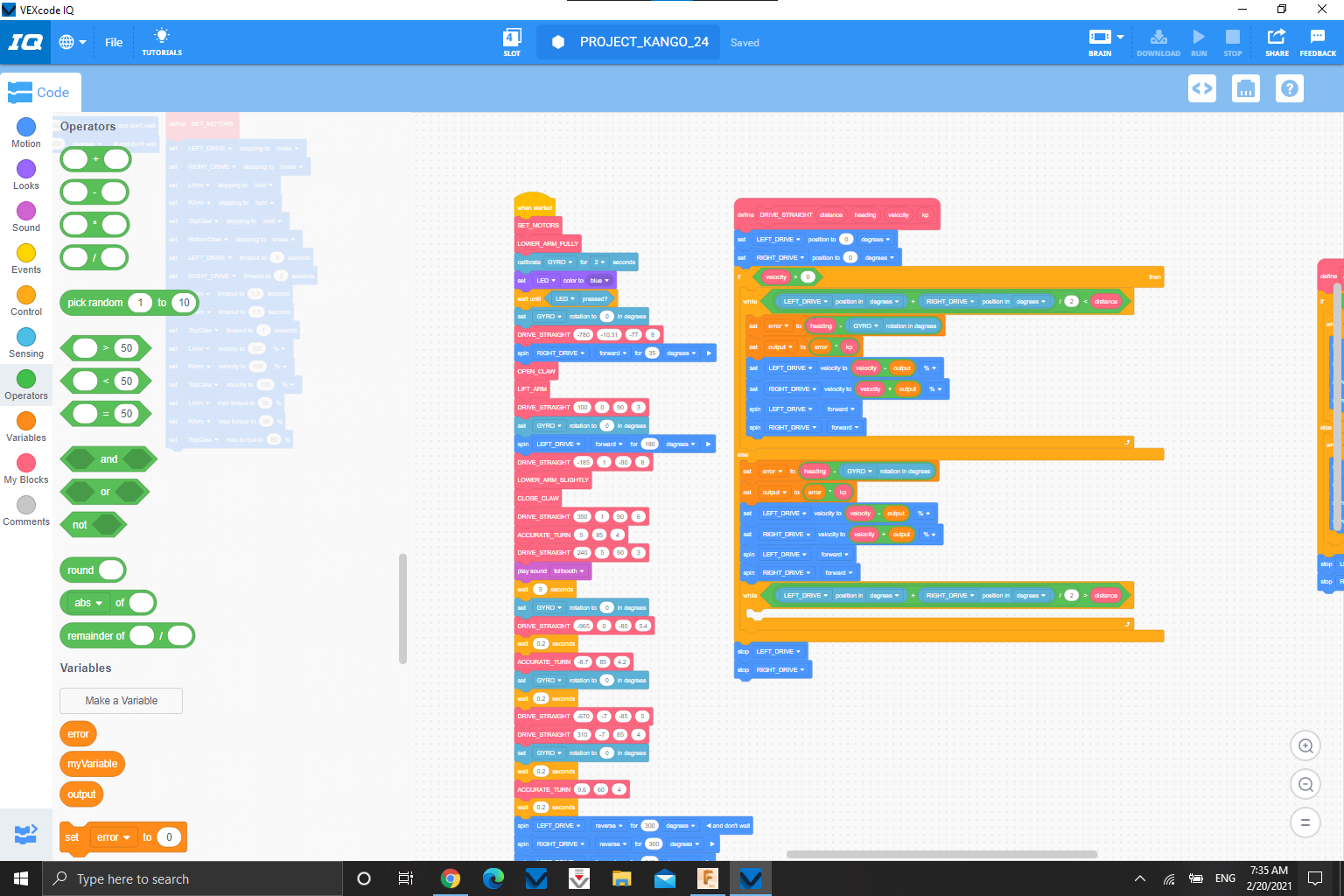

My program is spinning in endless circles instead of driving in an arc. It has always worked until now. I have a tournament very soon.
Please post your code?
And format it please. We can help you if we can better understand your problem. Thanks!
It is in Vexcode Blocks.
Here’s a screenshot:
It’s the top third pink block under the “when started” block.
Never mind, someone (@Noah10851B) figured it out. It’s the while loop in the function. I did not realize that it was out of place for some reason.
