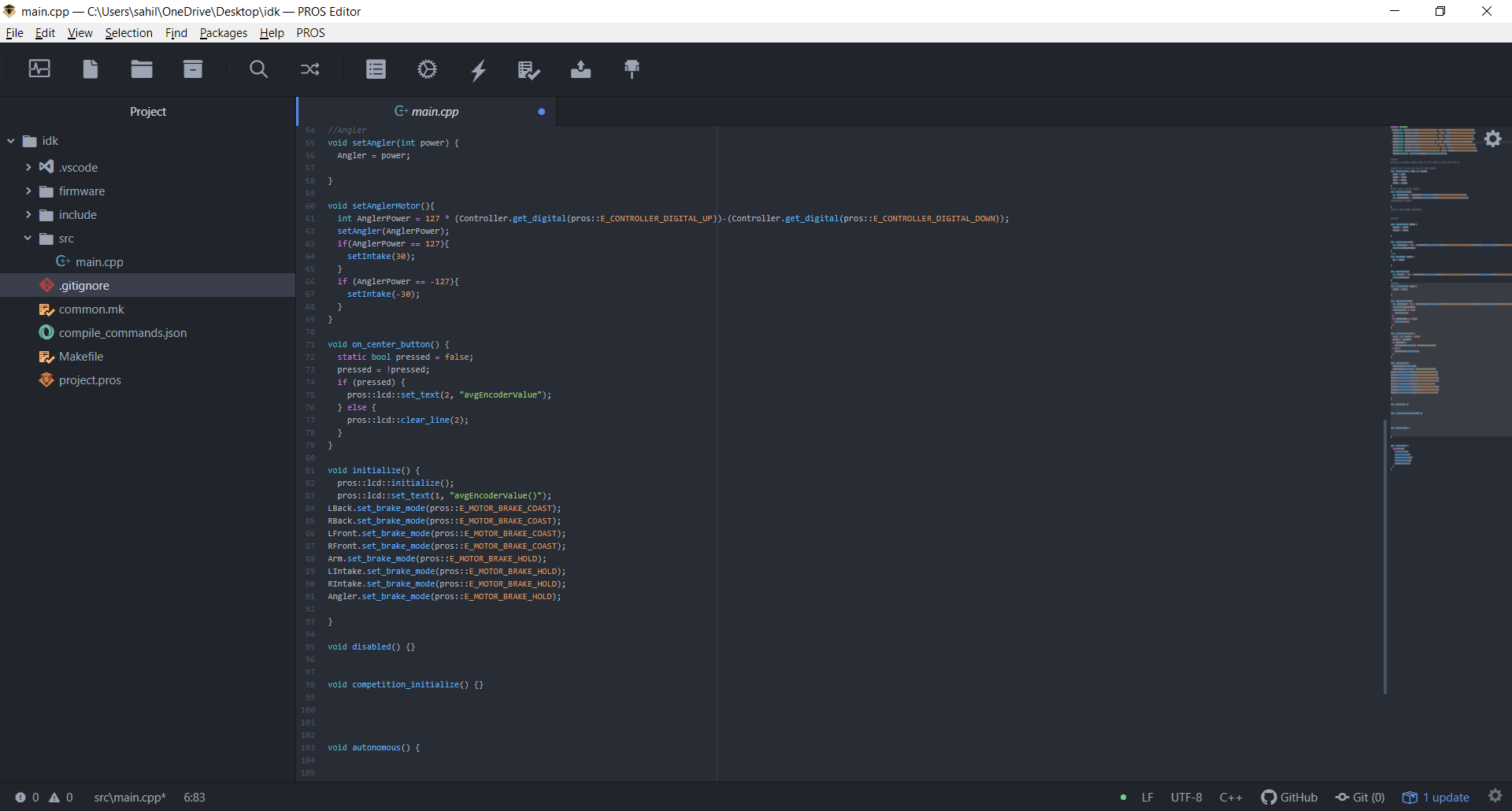

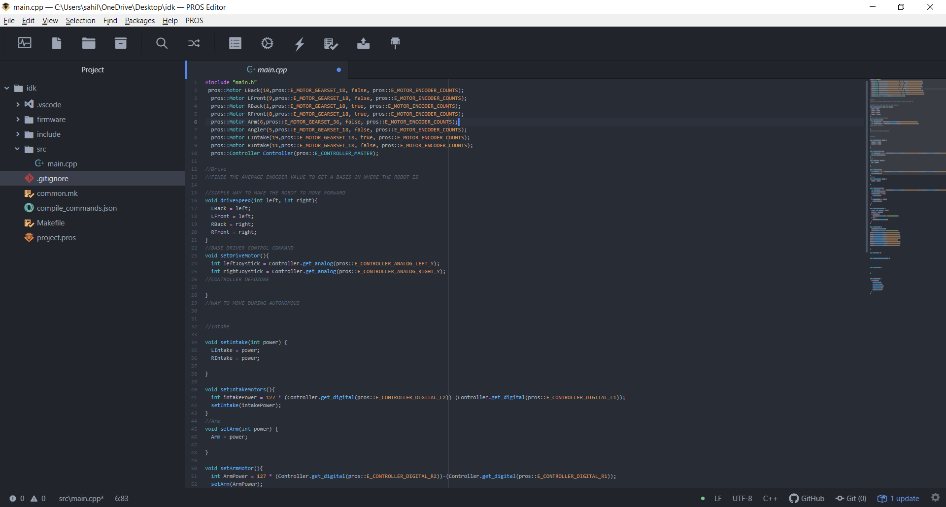

MY PROS Project won’t work no matter how hard i try. Can someone debug this for me?

No matter how i hard i try i can’t seem to get this program to work. Can someone debug this for me?

Can you give a bit more detail then it isn’t working? How does it not work? What are you expecting it to do?
Like @Johnmandrake said, what isn’t working.
From a cursory look, the only thing I see is driveSpeed(leftJoystick,rightJoystick) is not called in setDriveMotors().
A non-technical issue I see is that you have L2-L1 and R2-R1. It may not be wrong but since L1 is above L2 on the controller, I’d expect L1 to make a mechanism go “up/forward/out” with a positive motor voltage and L2 make it go “down/backward/in” with a negative motor voltage. Since you are not commenting your code no one else knows what’s suppose to happen. It may be that the motor is placed so it works that way but it is not obvious. I’d explicitly make it obvious at least in comments.
It doesn’t move or do anything except the intake works:)
It said that I could only put 1 picture per post so created multiple. Sorry about the inconvenience!
Count your parentheses in arm, intake and angler. Mult takes precedence over sub.
You shouldn’t split it up to so many functions. Its hard to read and confusing.
Try that first.
