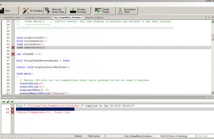

I am coaching a team for the first time this year. We have been to one competition and have our second this weekend. We have finally got to the point of being able to run autonomous but we have the program messed up. I have two errors that I can’t figure out. If anyone can lend some assistance we would appreciate it!
Thanks in advance.

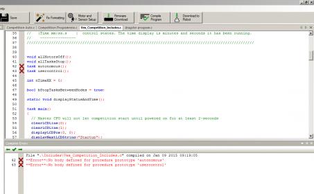

Wrong picture, this one is what the error reads.
You are showing errors in the competition template. You should have two tasks in the code you wrote with the same names, these are normally setup for you when you create a new competition file. Something like this

Are you compiling the correct file?

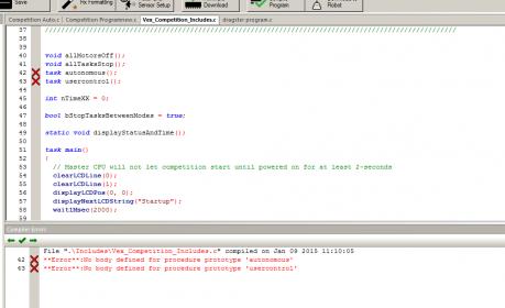

Now this is the errors that I get.
It may be the keys or it may be the cortex and joystick.
You can check the cortex using the ROBOTC software inspection menu (may need to enable “expert menus” first under the window menu) or using the VEX firmware upgrade utility.

I feel like you are still trying to compile Vex_Competition_Includes.c, you don’t need to do that, only compile your competition code file. It also looks like Vex_Competition_Includes.c has been messed with as I don’t see the prototype for the pre_auton function above the usercontrol prototype. Normally the top of this file would look like…
void allMotorsOff();
void allTasksStop();
void pre_auton();
task autonomous();
task usercontrol();
int nTimeXX = 0;
bool bStopTasksBetweenModes = true;
So lets back up, which version of ROBOTC are you using? Have you changed Vex_Competition_Includes.c? Are you trying to compile more than one source file?

Yes, but I think someone has changed the Vex_Competition_Includes.c file which is why you have errors.

Attached is a standard Vex_Competition_Includes.c from a clean copy of ROBOTC V4.27.
On my system this is in the folder.
C:\Program Files (x86)\Robomatter Inc\ROBOTC Development Environment 4.X\Includes
Compare with what you have and replace if you feel it’s necessary.
When compiling your source file you will still normally see two warnings.
File ".\SourceFile002.c" compiled on Jan 09 2015 09:26:19
*Warning*:Unreferenced function 'UserControlCodePlaceholderForTesting'
*Warning*:Unreferenced function 'AutonomousCodePlaceholderForTesting'
But that’s ok, you can generally ignore warnings anyway.
In fact. the warning about pre_auton you could probably also ignore, it just worries me that other things in the competition template may have been changed. Is there any chance this is a special version just for PLTW?
Alternative, just delete the pre_auton function (ie. back to what you started with) and that warning will go away, in which case your original problem was just compiling the competition includes file when that’s not necessary.
