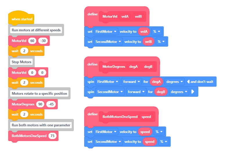

A motor cannot be put into a Motor Group and run individually when using the devices tab. You can define two motors in the devices tab, and then create custom functions to have them run together.
Here are some examples. The custom functions are defined on the right and then called from the main ‘When Started’ event.

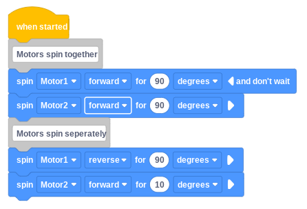

Usually when you want 2 motors spinning together, you would use a motor group, but in this situation I would keep the motors separate, and control them like this:
Screenshot 2024-05-03 7.57.16 AM
Use the “and don’t wait” at the end to make 2 motors spin at the same time
