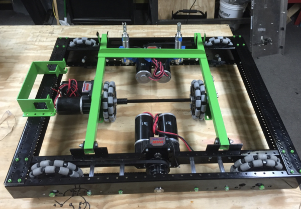

Yes. Moving side to side with omni wheels. That’s what I mean. 4 omni-wheels make up the standard drive train (forward, back and turning) and then a set of omni-wheels in the middle that carry it side to side.
Pictures?
This isn’t my bot, but it’s the wheel set up I’m talking about.

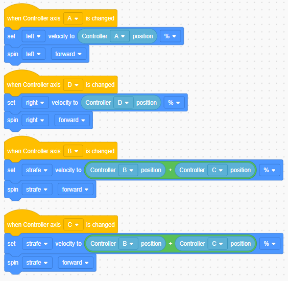

Images of your current code
You would program the side to side joystick axis you want to forward and reverse the motor at varying speeds based on joystick position

Images of all your code?
Also you should be able to do:
Strafing motor = joystick # power
This would let either stick move the strafe motor left to right. You will have to be careful to set up your motors properly.
That is GREAT! Thank you so much. I’ll be testing this out next week.
