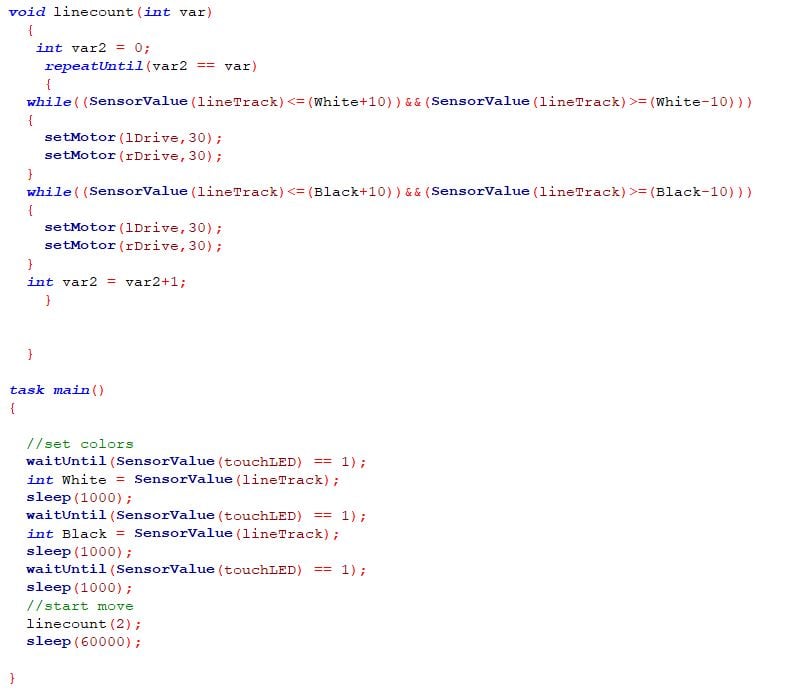

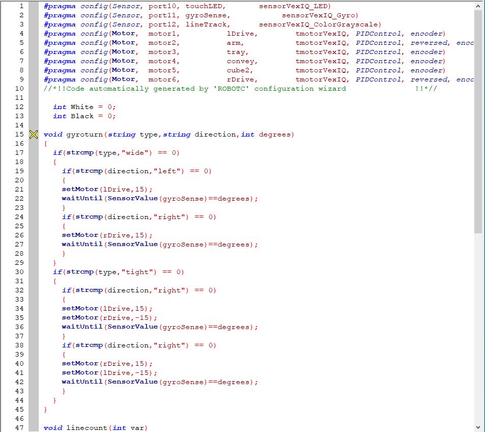

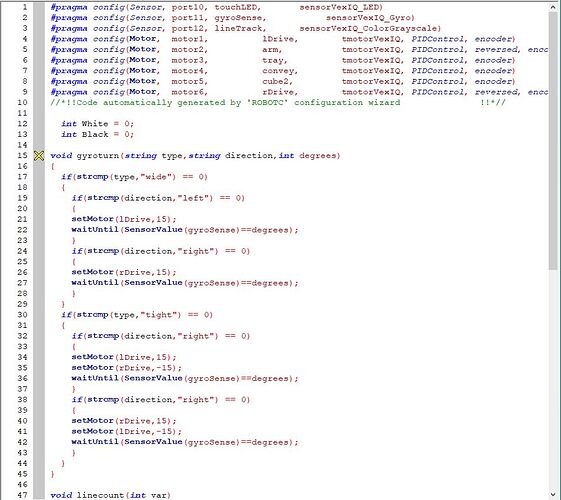

This function is just skipped over. I need help. When I run it, linecount does nothing.

When you say it doesn’t work, what does it do? Looks like it will drive forward for quite a long time. You don’t have any turn code and you don’t tell it to stop.
you assigned 0 to var2. var is assigned 2. They you repeat until 2 == 0. it is forever looped there and will be stuck forever.
It completely skips the function.
I tried it so it displays text after the function and it displayed the text before even moving.
i think the thread is stuck inside the function
What do you mean Eden?
im sorry i read it incorrectly because of the indentation

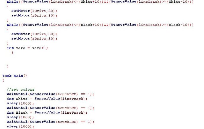

where did you declare black and white? is it a global variable?
I think it is an issue with the repeat command.
I have done the exact same code outside of a void command and it worked like a charm.
since you declared it in int main(), i dont think the function can access it
isusse
firstly, declare white and black outside of any scope (so they become a global)
It already is. It is outside of taskmain.
I changed it.
Im going to try it out.
normally linecount cant acces white and black and should result in an error, but idk how you got it to compile
Oh!! Do I need to do something like SensorValue or VEXRT?

since you declared white and black globally, and then declare it again locally, it means that main() will edit the value of the local one not the global one. To solve this remove the declaration part (the int) in main()
