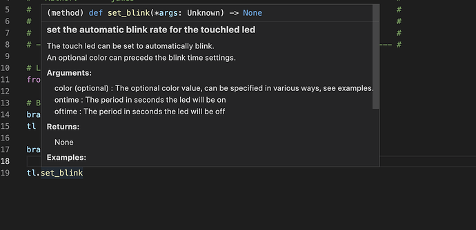

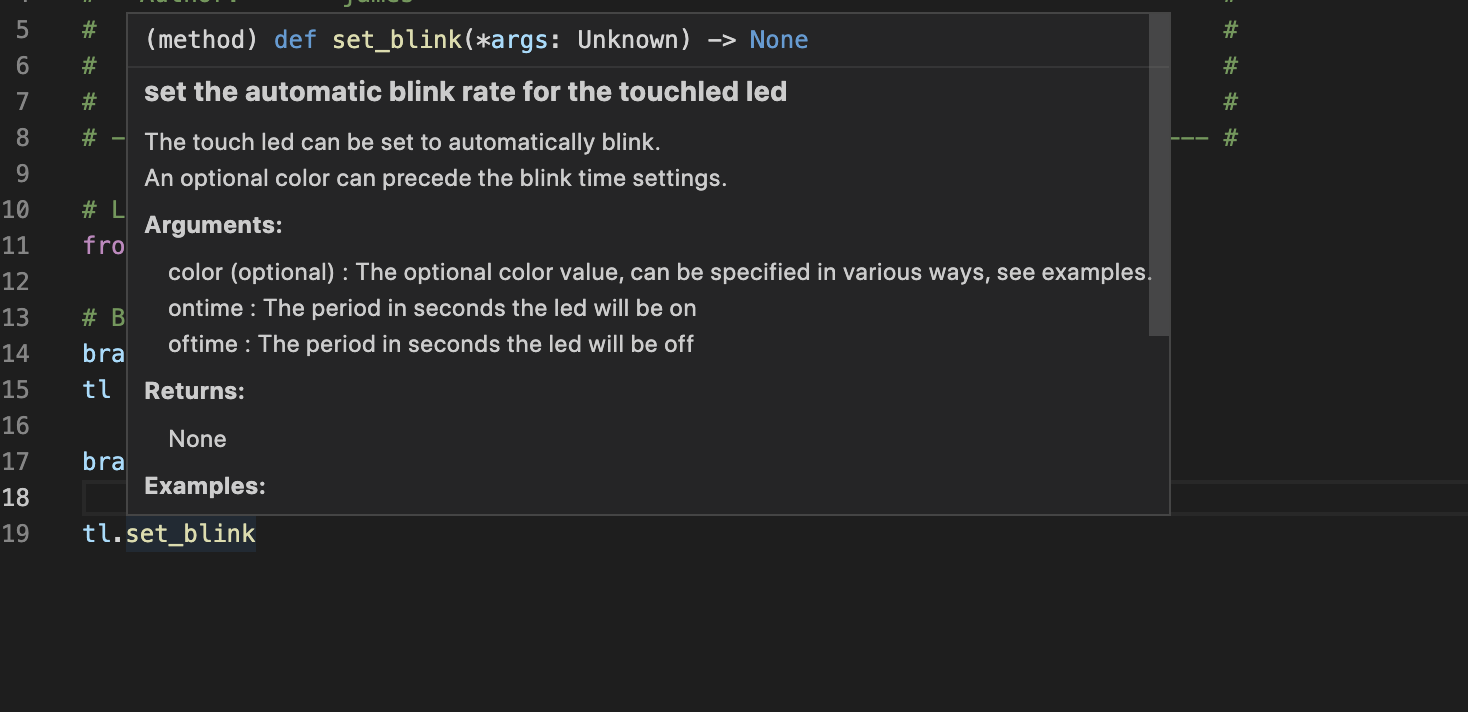

One simple way, use the set_blink function
shh im trying to get them to think through it
Hi!
Is it a function for the Touch LED in IQ VEXCode? Because I can’t find it…
yes, it doesn’t show in the drawer or autocomplete, but it’s a valid function.
(many of the more advanced functions do not show)
touchled_12.set_blink( Color.RED, 0.5, 0.5 )
I’ll ask, is the full API set documented somewhere?
It worked, thank you!!
