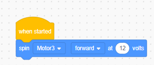

Looking at the VEXcode V5 blocks software, it appears that there are only options for 2-motor or 4-motor drivetrain groups. That being said a 6-motor drivetrain group is not listed or possible so you’re going to have to code each motor individually instead.

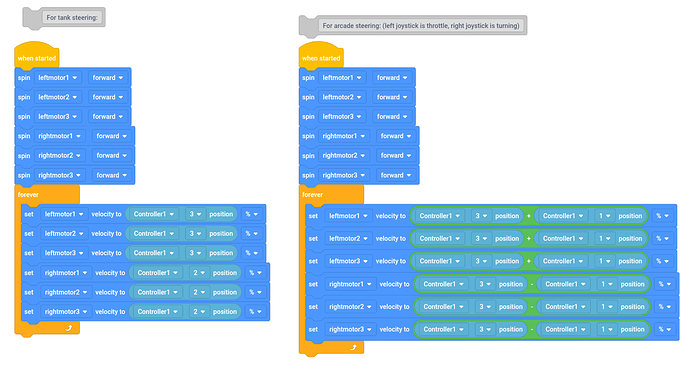

Was anybody able to accomplish this using blocks? If so can you post a screenshot of your code please. We have been using block programming and students are seeing the value of a six motor drive now. If not can you set up two drive trains to one controller? I think we used to do that with the v4.
Does this work? I am doing 6 motor drive for the first time and have no idea on how to program it.
Here’s a similar program to the one I showed
DriveControlDemo.v5blocks (38.3 KB)
This one can swap directions and control types, but doesn’t have a speed control option like my team’s actual code does
You will want to change motor directions to match your drive’s gearing
And yes, it’s a proven code
