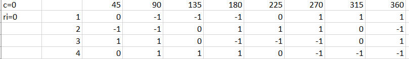

With an x drive, it is pretty trivial to figure out how to go in 8 directions (up, down, left, right, and diagonals) so I started with a table like this:
Let me explain what some of those variables represent.
  • c is spin, everywhere you see a c in this explanation, it means spin.
  • ri stands for “initial angle” from when I was doing diagonal spinning, it just is the direction that I want the robot to go in. Later, the input from the controller will be put in as ri.
  • the 1, 2, 3, and 4 stand for the motors. 1 is top left, 2 is top right, 3 is bottom left, 4 is bottom right
  • the angles across the top are ra or “actual angle”. This is the angle that the robot is facing in with facing forward being 0. This will later be measured with the inertial sensor

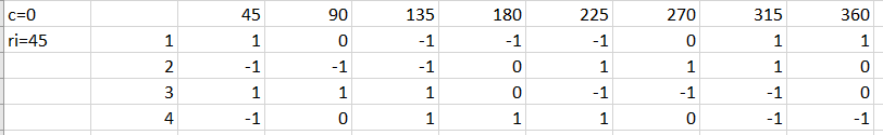

The data shows what power values I have to give to which motors to move the robot in whatever direction ri is if the robot is facing in the top angle (ra). For example, the last column on the right shows that in order to move the robot forward (ri=0) when the robot is facing forward (ra=360), the 1st motor has to spin forward, the 2nd motor has to spin in reverse, the 3rd motor has to spin forward, and the 4th motor has to spin in reverse.

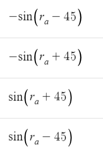

Now how do I calculate the values in between 0 (360) and 45 degrees?

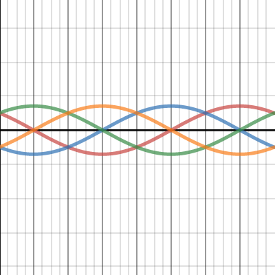

At this point, I switched to desmos and I started to construct a sine function to fit my data.
These are my sine functions:
super simple sine functions

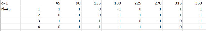

Of course, they aren’t perfect, I want to add more variables to them like c and ri and the scaling is weird, right now 360 tells each motor to spin at 70% power. So I made more tables (I included the 1st one for easy comparison):

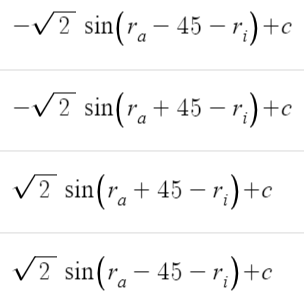

As you can see, the difference between the 1st and 2nd table is just that each value is moved over 45. Like the column for 45 in the first table is the column for 90 in the 2nd table. This translates to a -ri in each of the equations.
The difference between the 2nd and 3rd table is more discrete, more interesting. On my table, 1 and -1 don’t mean literally 1, they just mean that the motor has to go forward or backward. A spin of 1 (c of 1) just makes the wheels spin forward more. Look at how it cycles in row 2 (for motor 1): 1,1,0,-1,0,1,1,1. C just moves the sine functions up and down. I also scaled the sine functions by sqrt2 in this step to make it so they are nice and give 1 or greater and not smaller values. It really doesn’t matter what I scale it by because I will rescale it later but just run with the sqrt2 for now.
So we have our basic, fundamental equations:

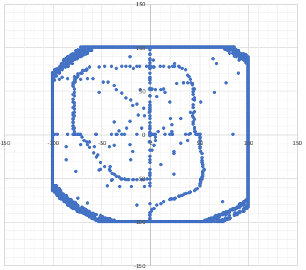

These are the values that my controller can produce:
jank
IDK if it is obvious, but that is not a circle with radius 100 like I thought it was.
The angle finding software didn’t work right and my f was going all the way up to 130 at times.
I had to find a way to get that to give me a direction and a f.
After a few days of headbanging, anger, and bad solutions, I came up with a super slick way to just ignore that jank.

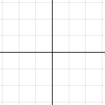

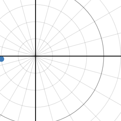

I made it so that if the f value was more than 100, I would just compress a and b so that f was 100. By doing this, I essentially made the controller give outputs in a 100 radius circle, which was what I wanted. I am really proud of how I solved this problem.
Here’s the desmos:
If you drag the black point around, the blue point always stays 100 away from the origin and is always at the correct angle. (unless you drag it to 0,0 but don’t worry about that)
