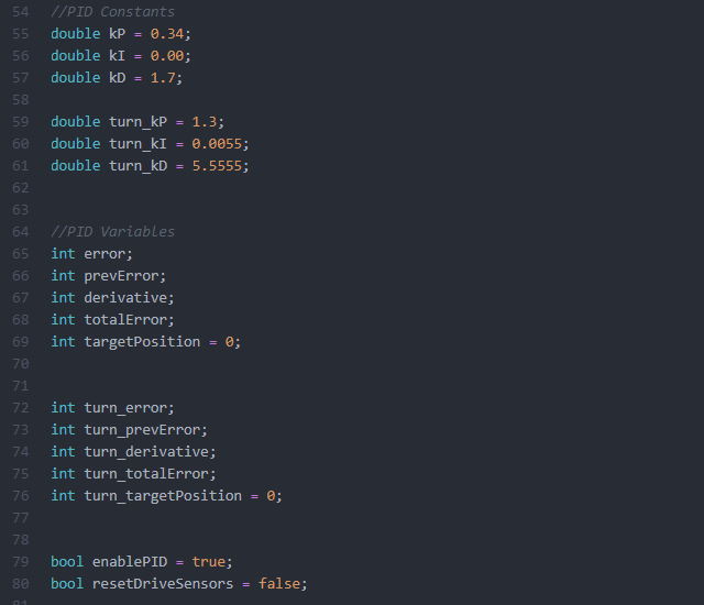

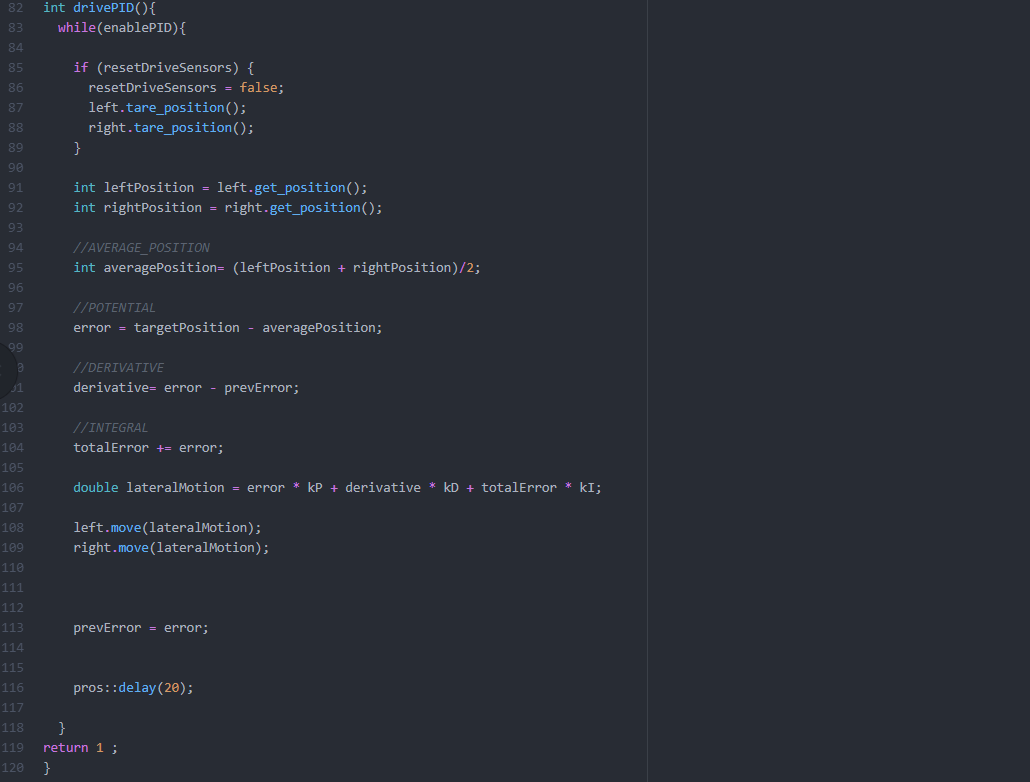

This is our code. We’re only using the motors encoders. Please take a look and tell me if there is anything wrong with it.
Looking at your driving code, I don’t see anything obvious that would cause a turn at the end. My guess is that one side of your drive base is higher friction than the other. You could try to fix this mechanically, by making sure your wheel assemblies are well aligned and using lube.
FYI, you can test how much power is used to turn the wheel at full speed by turning your robot on its side, navigating to the devices menu on the brain screen, selecting each motor, and pressing the arrow until it reports that it is spinning at max speed. It will also tell you how many watts it takes to maintain speed. This number would ideally be the same for every wheel assembly, and I’m guessing it’s not.
My second suggestion would be to calculate motor power individually. Essentially, calculate 2 lateralMotion values, one for the left error and one for the right error. This would ensure that each side independently reaches the desired distance, but can also result in drift to one side if one side accelerates faster at the beginning.
Finally, I’m just going to re-emphasize this as a possible solution, my PID code incorporates this:
But again, my guess is that your problem is mechanical, so you should start there.
I’m noticing also that you’re using motor.move(). If I’m not mistaken, that’s voltage control. I would actually suggest changing to velocity control (move_velocity?), this will make your base less sensitive to small differences in weight of the robot and different friction between assemblies.
Generally when using PID you use voltage control, because otherwise if you use velocity control then you are effectively putting the output of your PID loop into another PID loop, which can cause strange behavior.

I would reccomend writing a program to print out the encoder values for the right and left sides then comparing them after moving in a straight line (with the unwanted turn)
If the values are the same after a straight line + slight turn, it means the encoders aren't picking up the turn
It’s most likely a combination of backlash between the wheel and the internal encoder and the wheels slipping. If the encoders picked up the chassis turning after a straight line, the control loop should straighten out the robot.
My team switched to external encoders because we’ve always found the internal encoders inaccurate and prone to wheel slip.
If the values are different after a straight line + slight turn, it means the control loop isn't straightening the robot.
