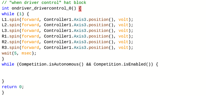

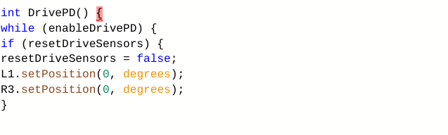

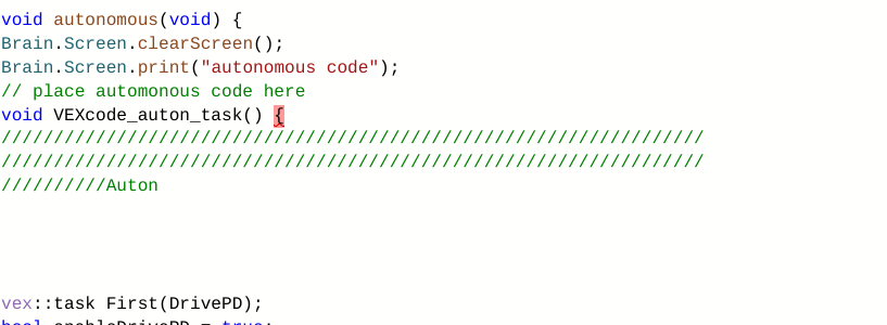

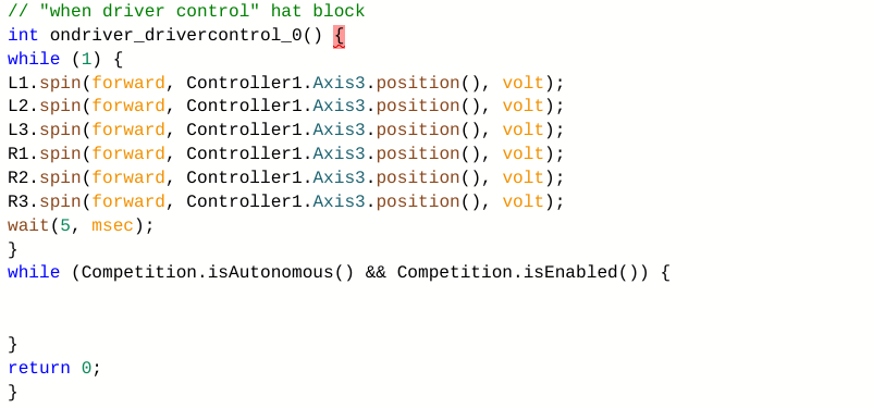

I need some help with my code (c++), I have errors marked on some of the { .
The 6 lines with errors are: ,with full code below
I’m hoping this is a simple thing that I need to change.
Full code below:
Please relpy with help, thanks!

int DrivePD() {
while (enableDrivePD) {
if (resetDriveSensors) {
resetDriveSensors = false;
L1.setPosition(0, degrees);
R3.setPosition(0, degrees);
int leftMotorpostition = L1.position(degrees);
int rightMotorpostition = R3.position(degrees);

void autonomous(void) {
Brain.Screen.clearScreen();
Brain.Screen.print("autonomous code");
// place automonous code here
void VEXcode_auton_task() {
//////////Auton
vex::task First(DrivePD);

int ondriver_drivercontrol_0() {
while (1) {
L1.spin(forward, Controller1.Axis3.position(), volt);
L2.spin(forward, Controller1.Axis3.position(), volt);
L3.spin(forward, Controller1.Axis3.position(), volt);
R1.spin(forward, Controller1.Axis3.position(), volt);
R2.spin(forward, Controller1.Axis3.position(), volt);
R3.spin(forward, Controller1.Axis3.position(), volt);
wait(5, msec);
while (Competition.isAutonomous() && Competition.isEnabled()) {
return 0;

Its probably because you declared the functions inside a function(i pasted it into vexcode). I would recommend you fix the indentation to see it easier, and to go on from there.
For the first snippet of code (int DrivePd), you forgot to set a closing bracket for the if statement & the while statement.
For the second one, you forgot to the close it yet again.
I’m not quite sure about the third one, since it’s difficult to tell what’s going on without proper indentation. Same for the fourth, fifth, & sixth ones. I highly recommend indenting your code, as it is difficult to help. I hope you get the help you need, though!
