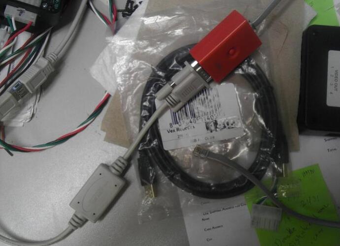

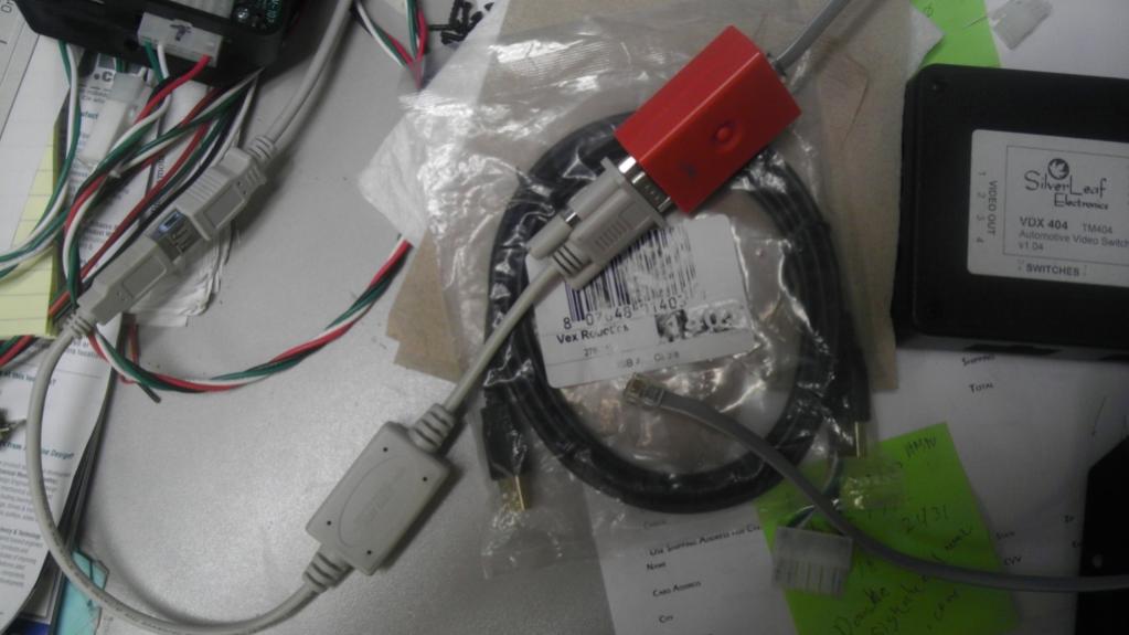

After using the Vex Robotics systems for almost 7 years, and the Prolific USB-to-Serial Adapter for almost 11 years, I would put the *some if not all *the Blame on the Prolific Drivers…
I assume that your using the same Computer or Model of Computers??
Before you toss out all your older Serial Programmers, get a FTDI based USB-to-Serial adapter and try that with the Vex RS-232 to TTL Adapter…
My Windows 7 Home Premium x64 system is stable with the Prolific Drivers, but I am running the 12-MAR-2010 version, 3.3.11.152.
I have found that some of the newer version from Prolific are quite unreliable, especially under Windows 7. Also, all the Vex USB-to-Serial adapters I have tested ( I have 4 ) are the HXA versions, which are Officially NOT Supported under Windows 8…
I have no idea what most of those words mean. Sorry.
We’ve used… four computers testing this. Two were 32-bit Vista, one was Windows 7, one was Windows 8. All of the USB-Serial Cables, plugged into a VEX Joystick which was talking to a Cortex Microcontroller, crashed nearly every time we used it. The USB Male-Male cables works perfectly every time.
If you wouldn’t mind explaining what you meant a little more clearly, we’re happy to do some tests. We’re perfectly happy walking around with my 10" laptop connected to the Cortex, though.
Not a Problem… I wasn’t sure how knowledgeable you were about the History of RS-232 Serial Ports and the Modern adapters ( USB-to-Serial ) that let you use the USB Ports on your computers to communicate with Devices that Don’t have USB Ports ( Or in the case of the Cortex and VEXnet, when the USB Keys or USB A-A Cable is being used…
Start with what Version the Drivers are, you can locate that in the Device Manager in the Windows Control Panel… The Vex USB-to-Serial adapters will be found under the Ports ( COM and LPT ) section:
[ATTACH]7263[/ATTACH] [ATTACH]7266[/ATTACH]
Double-Click on the “Prolific USB-to-Serial Comm Port (COMx)” and the Property Dialog Box will Open, then Click the Driver Tab:
[ATTACH]7265[/ATTACH]
The Driver Date and the Driver Version information is shown…
Mine is located on COM 3, and at this moment is not the Orange Vex Adapter, but a surprisingly similar looking one with the same Hardware as the Vex adapter:
[ATTACH]7264[/ATTACH]
You might not want to spend a lot of time on this Issue, but the benefit would be the ability to See RobotC Debug Data or EasyC “PrintToScreen” Info while controlling your Bot.
When ever I experience Communication Issue with a USB-to-Serial adapter, I look for Updates and Try another Version…
For the past 11 years, every few times Micro-Soft releases an Update for a Version of Windows, the USB-to-Serial Drivers seem to get broken
I am currently running the same version, ( 3.3.11.152 ) on Windows 7 Home Premium x64 ( SP1 ) and Windows XP x86 ( SP3 )
