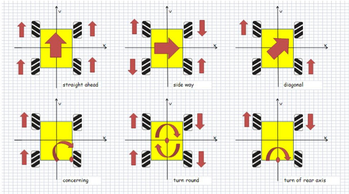

When programming a drive the general ideas is to add up all the values for the wheels, this may incude forward, sideways, left, right and/or turn. This picture shows the direction each wheel should go for mecanum wheels…
Using this your code should look something like this…

Also note that the reason you add up the values is to allow the robot to do multiple of these actions at once. Meaning it can drive diagonally by setting forwards and sideways to some values.
