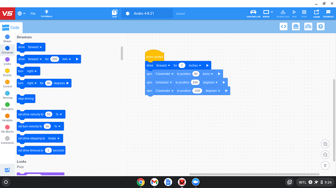

Hello, I am having trouble with programming my robot, when I put the block drive forward for 7 inches before any other block or the spin block the robot will only do that action and not continue with the other actions/blocks that I inserted into the programming, please let me know what to do, thanks.
Please post a screenshot of the program that’s behaving as you describe.
Screenshot 2021-04-30 9.24.50 AM
The issue may be that you’re asking the “Clawmotor” to spin 90 turns - in this scenario, you’re likely reaching a mechanical limit that is causing the arm to “block” the rest of the project since these commands are “blocking” commands - they will prevent any additional code from running until they reach the requested position.
Try changing “turns” to “degrees” and see if that helps.
