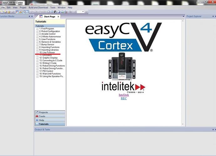

For our new Skyrise robot we will be using 1 line tracker. However because we haven’t used one before we are unsure on how to program them in easyC…

The line tracker block just returns a value from 0 to 1024. Are you tracking a line or touchless limit? I’d plug one in and open the online window.
No I am tracking a line…
Is there a sample code which I could look at?

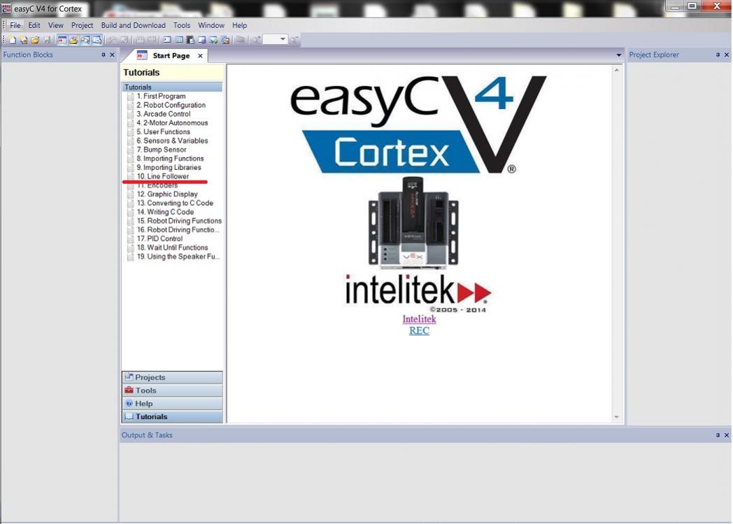

Yes, it is included in easyC under the tutorials.
We recommend using three though. With one you can only bounce off the line, plus the kit comes with three.
https://vexforum.com/attachment.php?attachmentid=8569&stc=1&d=1410379671
