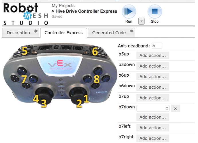

Controller Express. Looks like this is a way to quickly setup a drive program. Sort of reminds me of ModKit (scratch like programming app for Vex IQ). This would be for beginning beginners. You are presented with the image of a controller and you select which buttons you want to program.

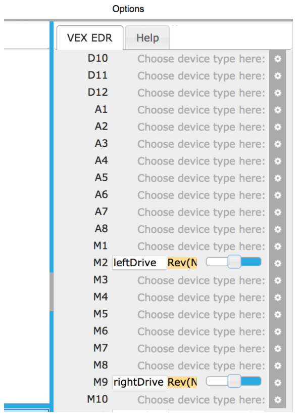

Motors and devices are setup in a panel on the right (exactly like Flowol (programming app for EDR & IQ)) and then map the motors to buttons on the controller.

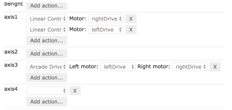

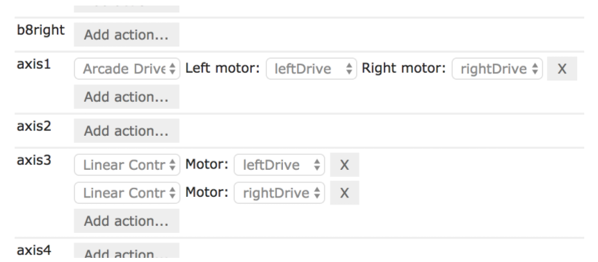

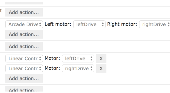

I want a driving program where the left joystick controls forward and reverse movement, and the right controls turning. There are options for Arcade or Linear Control (tank I assume). I kind of want both. In a few clicks I have this:

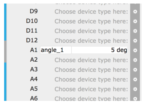

That was easy. Let’s download it. I have it hooked up in debug/programming mode. It downloads on the first try, and I’m getting status info on the potentiometer right away.
But for some reason the drivetrain isn’t responding to the controller. I start checking the cables, replugging in the USB, then realize that the cortex was not powered on (I’ll never get used to the lights being on when the power is not). Turn on power, but now I’ve lost my connection to RobotMesh Studio. I try everything to get it back, but it’s not responding. Exit and reopen the project, now it’s happy and will connect. I’ve tried many different programming apps for IQ and now EDR, and they all have their own quirks with losing their connection to the brain. You learn how what not to do and how to deal with it. This one is no different.
One odd thing is that there is a ā€˜Connect’ mode, where it shows you the active values of your sensors. But the robot does not respond to the joystick when Connected. You have to use Run to actually use the joystick, but then you don’t get any feedback from the sensors.

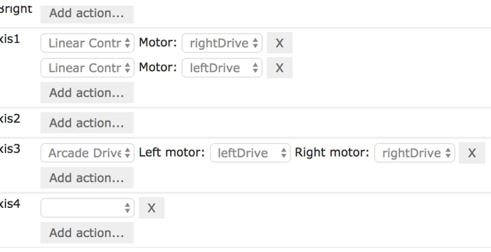

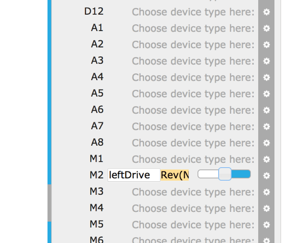

So now I’ve downloaded it, and it’s running but not as expected. Both axes are controlling forward and reverse, no turning. After trying few different configuration I get one that works.
You can’t see it in the screen print, but neither drive motor is reversed. Normally the right motor would be reversed. I’d have a hard time trying to explain this to the kids. Perhaps the two joystick driving program is unusual, but our high school FRC team (and I believe many others) use this driving style, I want to the kids to get used to it from the get go, and now they only want to drive this way.
The completed program almost works fine. The big problem is that you can’t turn and drive forward at the same time. You can either turn or drive, but no turning while going forward.
Let me see if the normal arcade drive using one joystick has this problem. After trying a few other configurations it seems that setting Axis 3 to Arcade is really like setting 3 & 4 together. 3 controls forward, and 4 controls turns. So there is no need to program Axis 4. However, it still has the same problem. You still can’t make a wide arcing turn by going forward while turning.

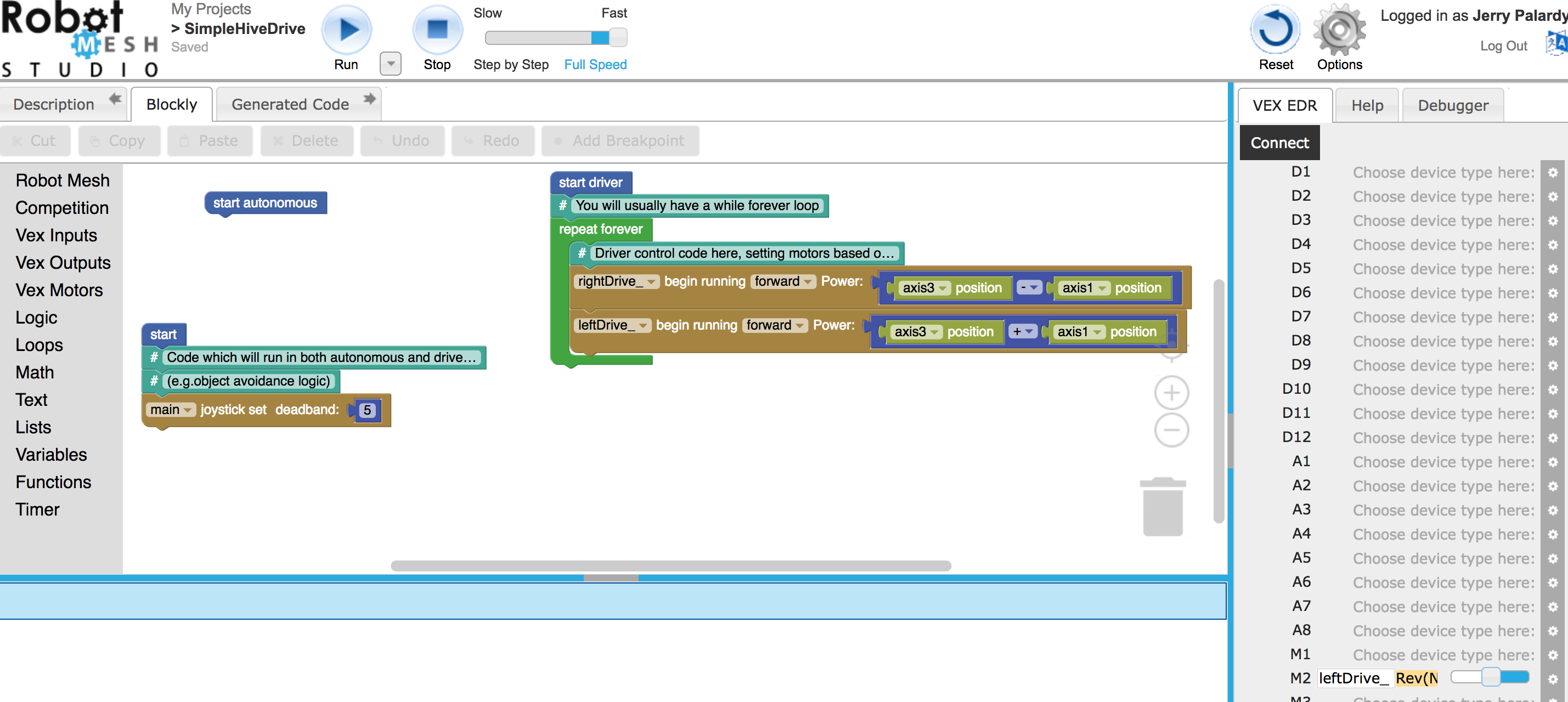

Blockly time…

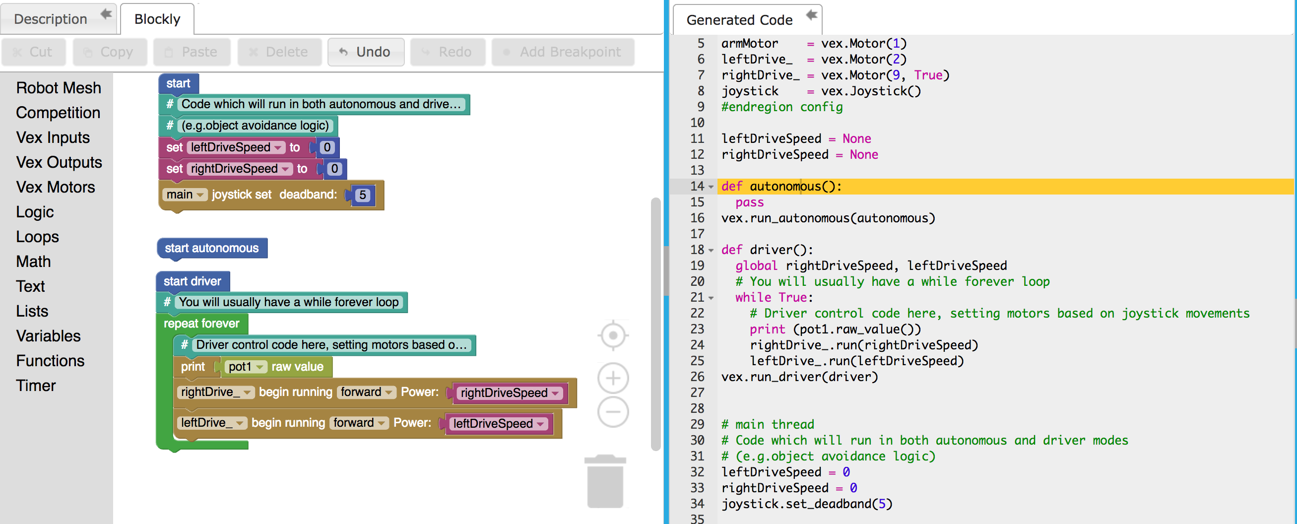

Blockly is a Scratch like app where you move around interlocking puzzle pieces together to make a program. An application like this is more appropriate for elementary aged students, but it is useful for some middle schoolers, or even high schoolers, that are getting started in programming, or just have no patience for syntax errors in a text based language.
In Vex IQ there are two Scratch like applications to choose from, Modkit and Blockly. Modkit was first on the scene and it is a little bit more polished and ā€˜elementary friendly’. Blockly is more powerful, but you occasionally get errors that would completely stump an elementary aged student or a non-technical teacher.
There is no Modkit version for EDR, but there is RobotC Graphical. When I looked at Graphical a couple years ago, it was still new and was missing some very basic capabilities, like variables. It has improved since then, and I plan to take another look at it. As of a couple years ago, Blockly was way better. Let’s see how it compares today.
Blockly is a browser based app with a plug-in that lets you communicate with the robot. I’m running it in Chrome on a Mac. Looks like they have added some training materials recently. The materials are for Vex IQ, not EDR but are still helpful.
The motor/sensor configuration is in a pane on the right (exactly like Controler Express), the program is in the center, and the block choices are on the left.

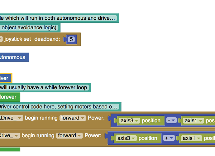

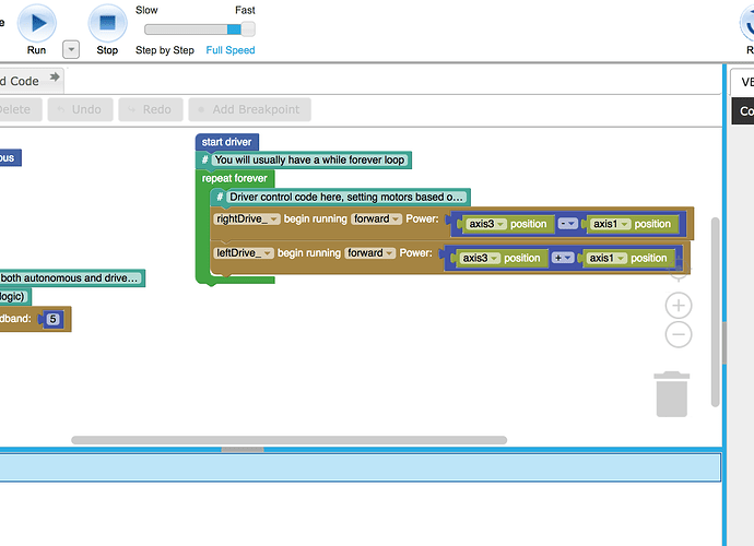

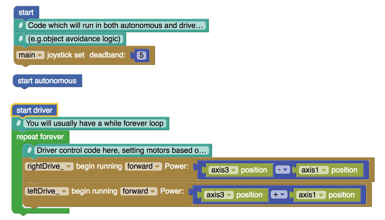

I configure the motors and create a drive program. As before I want the left joystick to control forward/reverse, and the right to control turning. In a couple minutes I have this completed program:
Download it. No issues. Run it. Works great. I can turn while moving forward to make long arching turns. Good thing, because this drivetrain pulls to one side and you have to constantly adjust it to stay straight. The debugger works fine when tethered, but not with VexNet 2.0.

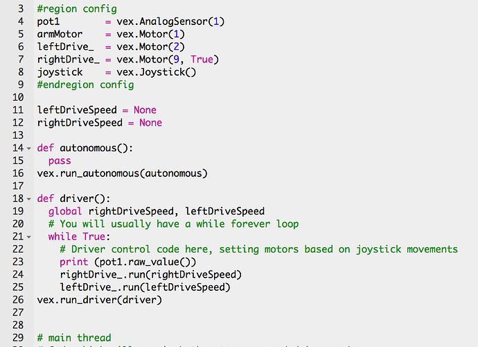

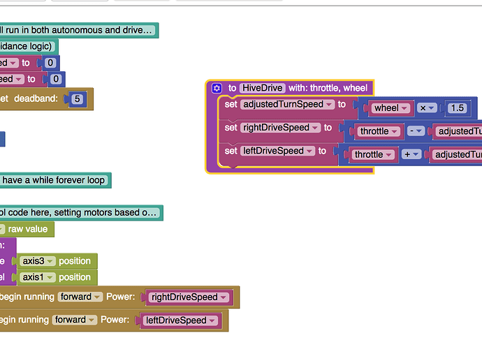

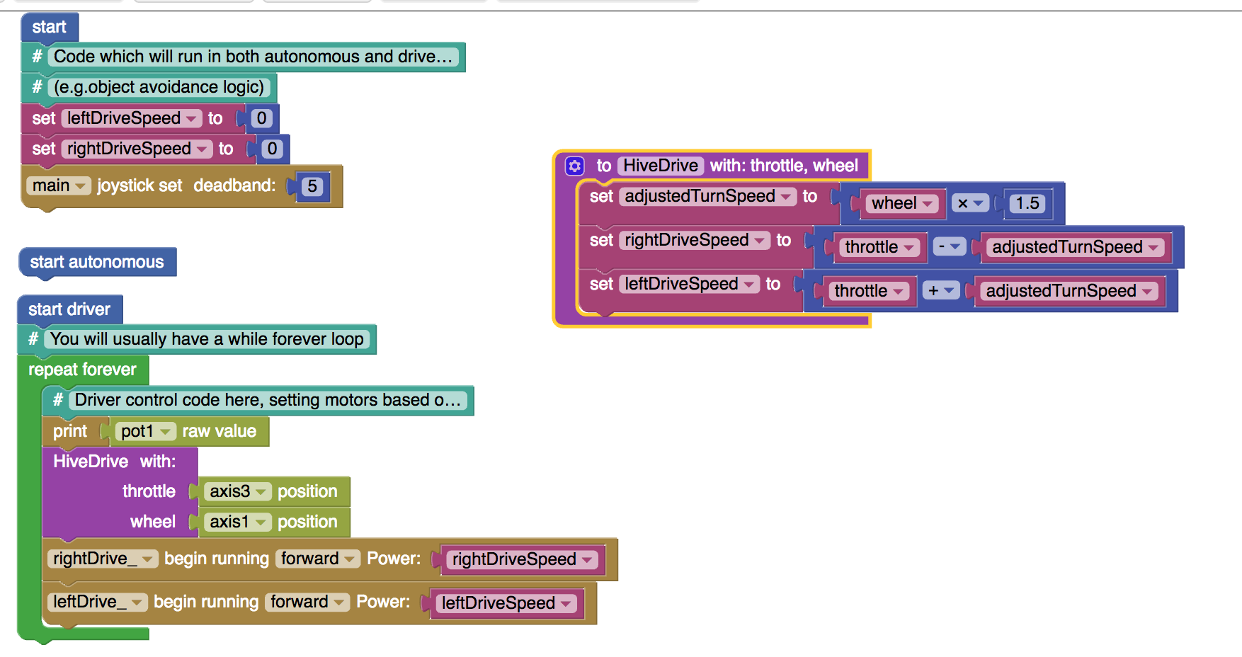

At this point I could call it good and be done, but I think the turning is a little bit too slow on this robot. I want the turns to be a little bit more sensitive. Here is the updated program with a function and a couple variables. Just the way I like it.

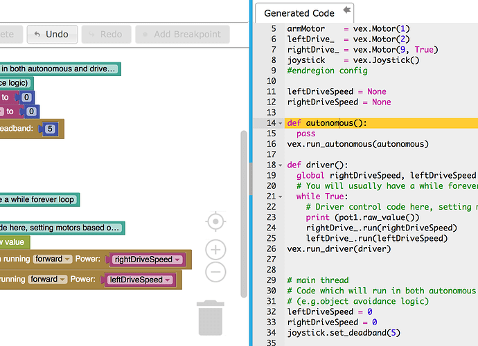

It shows you the Python code that is generated.
You can setup a split view too.
I’m looking for a way to edit the Python code, but I don’t see one. You can copy the code and make a new Python program from it. Being able to see the text based code that was generated from the blocks sounds like it would be a good learning tool, but I wonder if it really is.

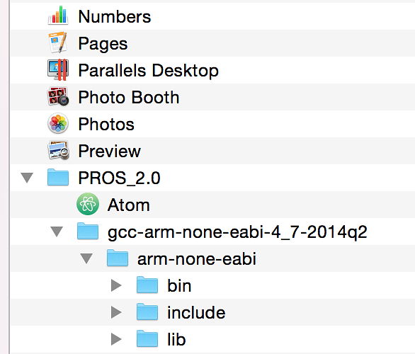

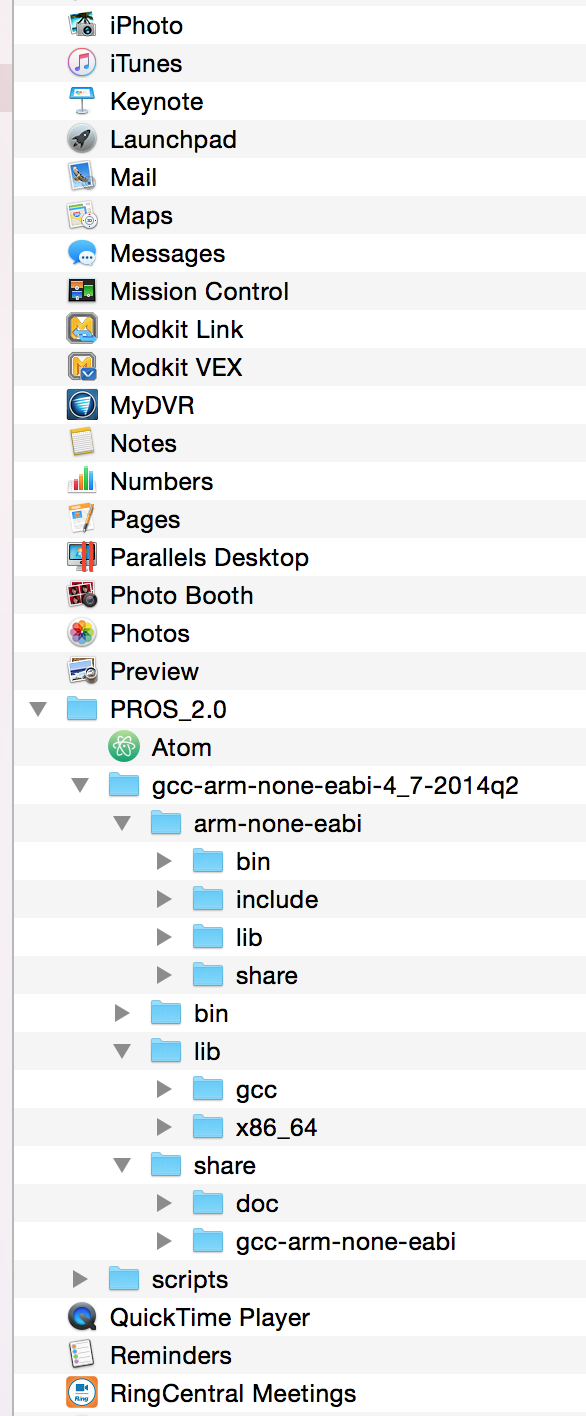

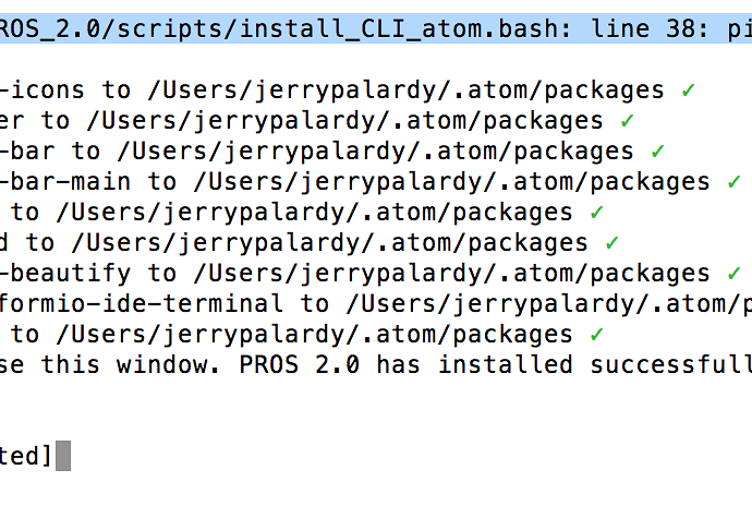

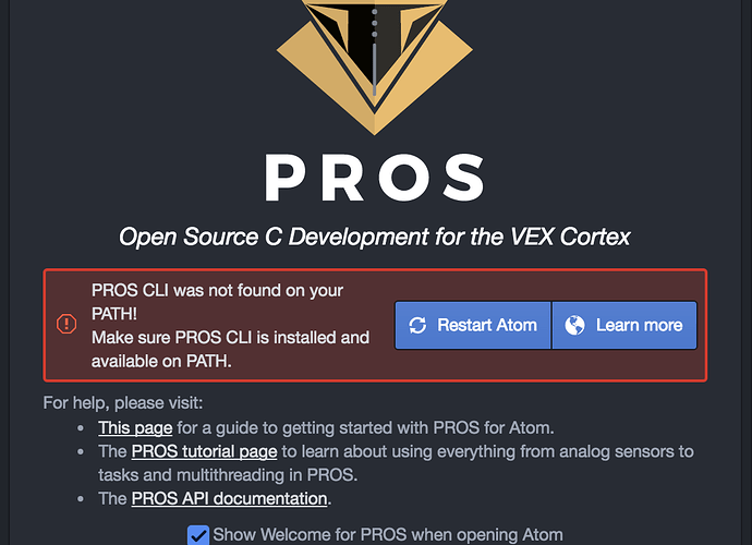

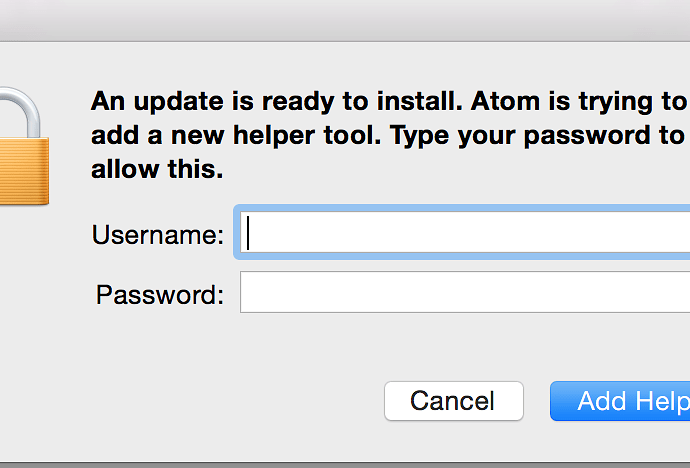

Mac install looks like it is going good, I don’t notice any errors. However, in the Application folder it has added a PROS subfolder. Nothing necessarily wrong with this, but it’s just not the Mac way of doing things.

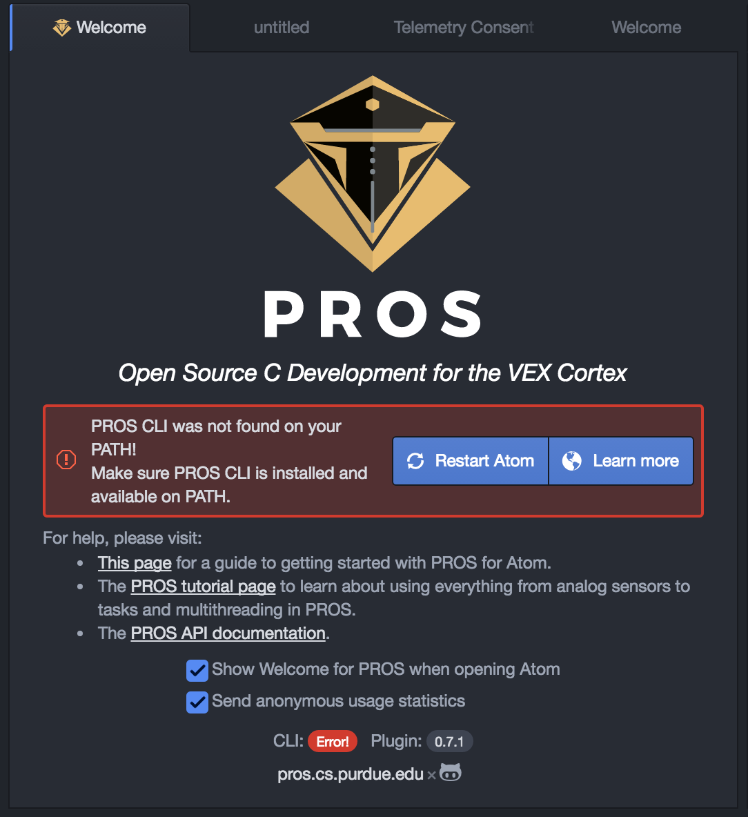

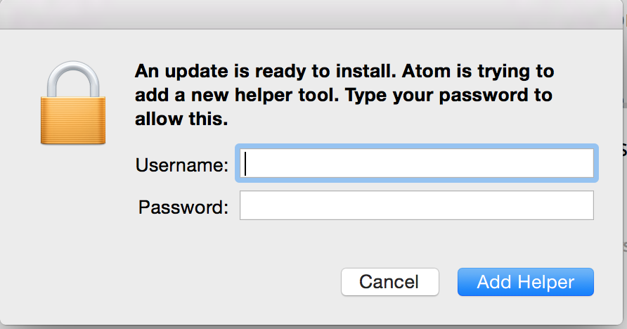

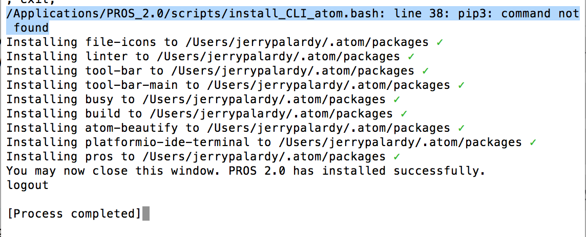

After the install is complete and I’m ready to open Atom, I get this message:
I enter my username and password, and the dialog goes away. But it doesn’t look like the install finished correctly, because error I’m getting this on the Welcome page.
Not sure what a CLI is, but mine’s messed up. Restarting, did not help and I don’t find any KI like mine. Let’s try reinstalling… Noticing an error that I overlooked last time.

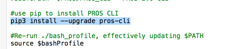

Let’s see what’s going on inside that bash file.
Apparently like I’m missing a app called pip3 that is needed to install the CLI. Betcha someone will post the solution to this issue within an hour.

If your missing pip, then go ahead and install python (3.7). Pip is the python package manager. Hopefully this will clear up any install errors.
PIP is Python’s package manager (pip3 is the one that comes with Python 3.X). Installing Python 3 should fix this particular issue.
CLI stands for Command Line Interface, and it refers in this case to our utility that performs project management and code flashing behind-the-scenes.
Note that installation on macOS has a few extra steps and prerequisites, which can be found here.
How’d I do? :slight_smile:
Two correct answers within less than 5 minutes. Lots of support for PROS on the forum.

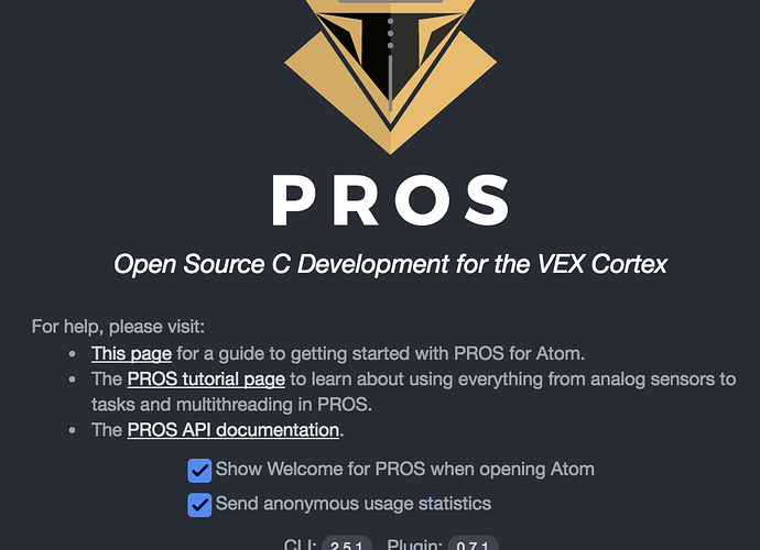

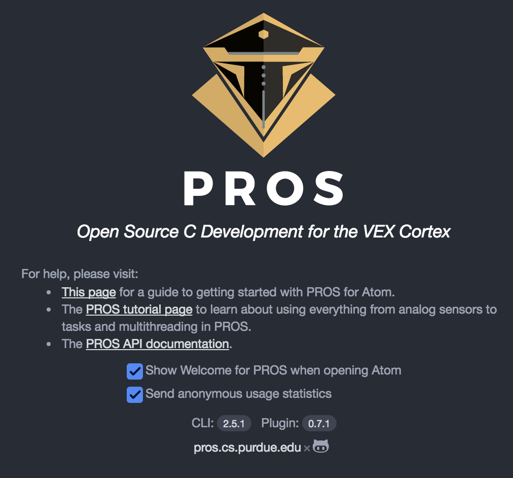

I was in fact missing Python. Fix that now back in business…
