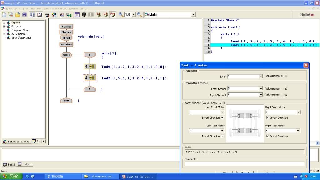

Well guys I wrote this programme and it made those motors not work well.they seems to be jammed, I mean when I push joysticks up or down, motors run Intermittently with strange sound.

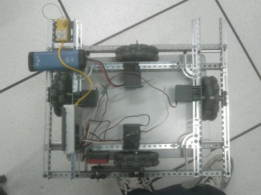

I am using EasyC for VEX 2.0.Here is the screenshot and the chassis.
Is it a bug or something wrong with my programme, or I have to get EasyC Pro?
Any suggestion would be grateful.
http://i191.photobucket.com/albums/z13/kongjw_1993/IMAG0112.jpg

It looks like you are driving the SAME motors with two DIFFERENT sets of controls.
One drive the motors from ch 2, 3 the other drives the motors from ch5.
The software shown reads ch2,3 then applies the values to the motors, but then the very next line cancels that and tries to drive the motors from ch5.
Then the loop repeats and the lines continue to cancel each other so the motors never do anything.
Delete the second Tank4 line and it should work fine (using ch 2,3)

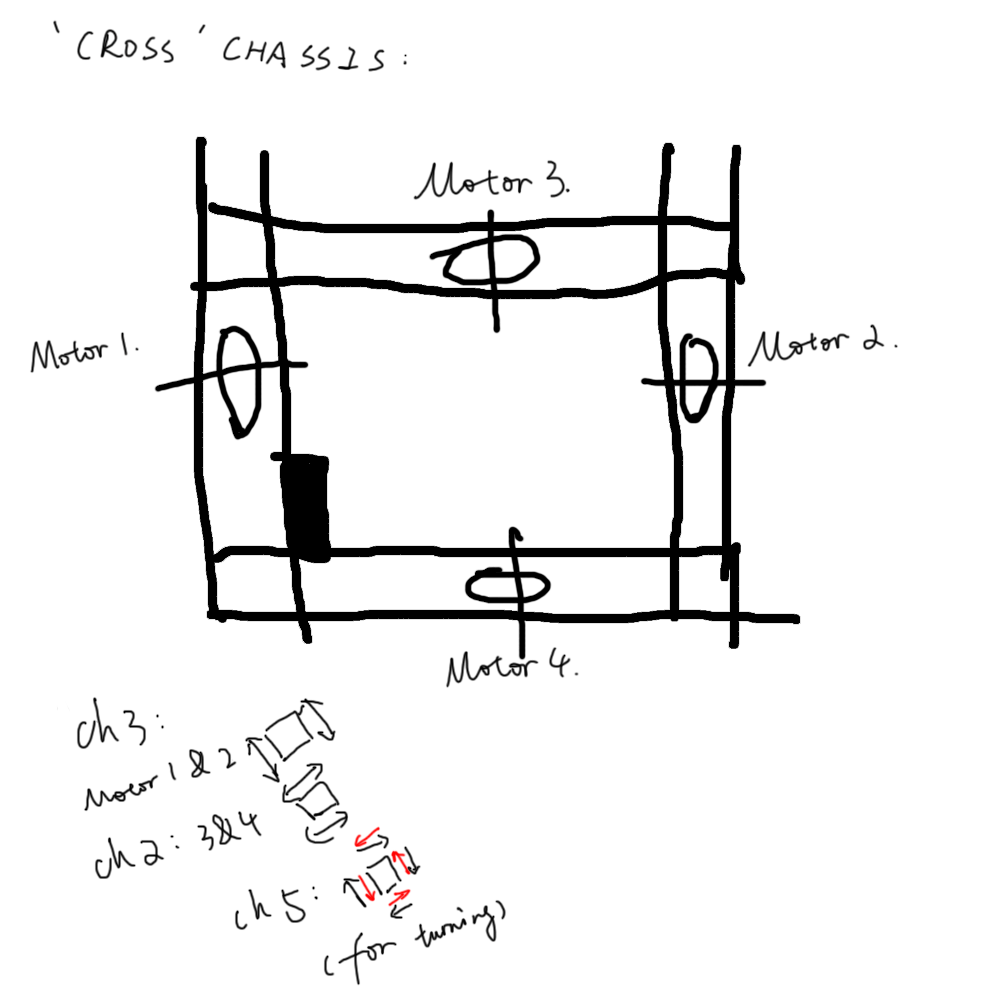

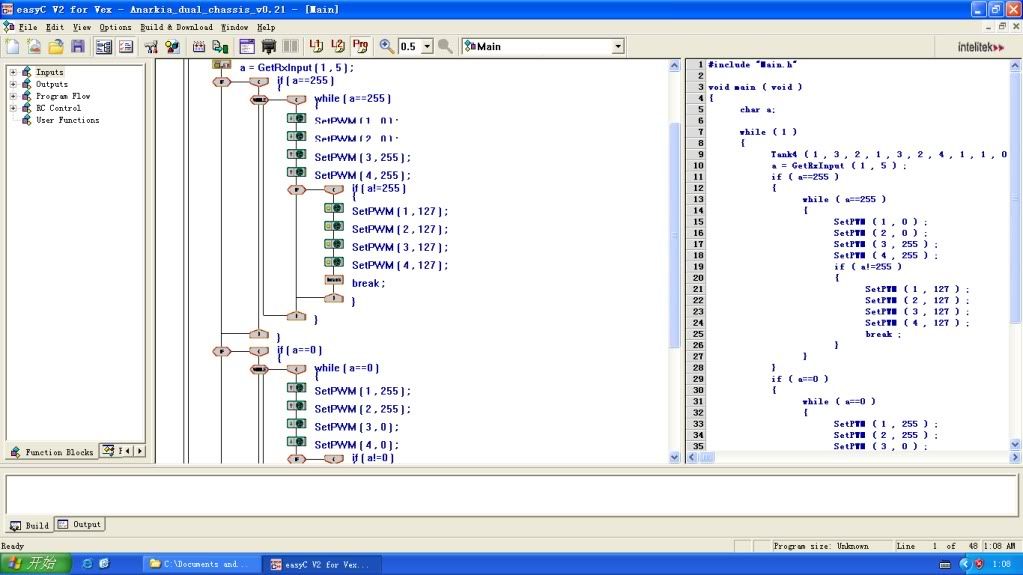

thanks for that and here is the programme modified.
The purpose is to use channel 3 and 2 for normal moving and channel 5 for turning.
There are the motor installation and a screenshot of the programme.Thanks for the notice DK lol.
So will it work or any setting should be changed? Thanks for your advice.

It looks fine from what i have seen except for one thing i would put the Tank4 block inside a loops so that you will only be able to do that if ch 5 is not being pushed at all. This way you will not set compromising signals to the motors which will cause them to twitch.

Channel 3 ---- Motor1
Channel 2 ---- Motor2
Channel 5 ---- Motor 3&4 (sideway movement)
Channel 6 ---- all motor for turning
I would make it something like this
Ch 2 Controls motors 1 and 2 for forward and back movement
Ch 1 Controls motors 3 and 4 for side to side movement
Ch 5 all motors for spinning
This just seems to make since.
To do this i would use the Motor Module Rx block instead of a Tank 4 Motor block. This way you could get it to run smoothly.

and just to be sure you added in a loop that says IF a==127 and you put you standard (not spinning) code in there? correct. If you do not do this then you may sent conflicting signals to the motor.
~DK
thanks for the notice, but I thought that it’s not necessery because there is no command to motor when a==127. Well I will make sure there is a command when a==127.
It may not be necessary but it is a good precaution.

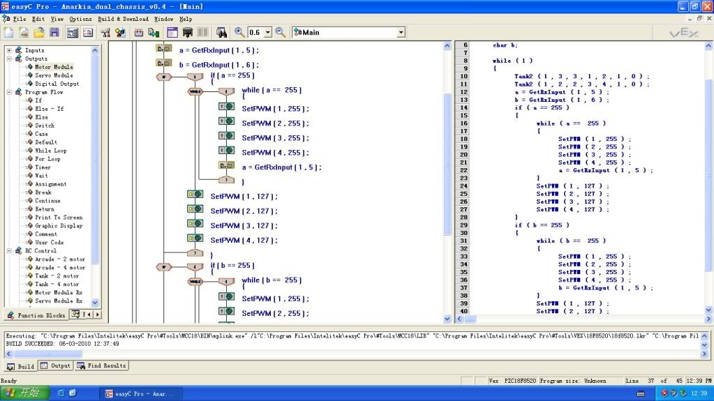

Well when I fisrt download the proramme my bot is able to spin only clockwise when I press button of Ch5.
Then I set ch5 for clockwise spinning and ch6 for anticlockwise, and it couldn’t spin at all,though normal movement is OK.
Hard for me to identify which step was wrong. Here is screen and the programme.

did you all forget about smartkid’s holonomic drive tutorial?
i think you can just download the code there
because i think its more complicated than the code you posted
(you needed to change numbers, and then change them back, and do a bunch of checks)
