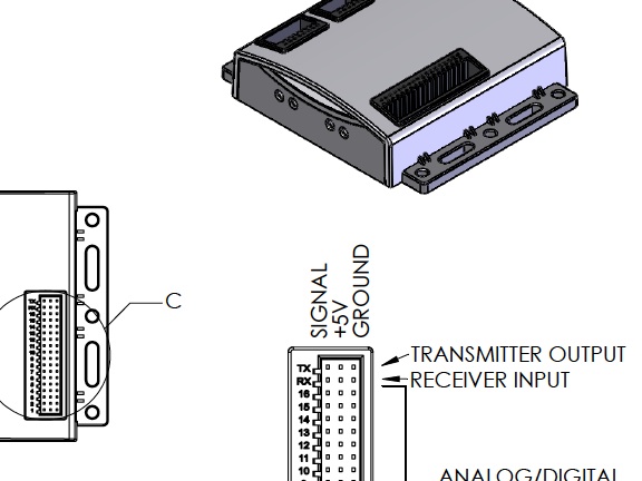

where do you expect to plug in a LCD on a PIC? there are none of the 4 prong plugs.
On the LCD info page, it says you need 2 3-wire extensions to plug the LCD into a PIC.
Line from VEX LCD page: “PIC Microcontroller V0.5: Requires (2) 3-Wire Extension Cables”.
Presumably it connects here to the TX and RX ports.
https://vexforum.com/attachment.php?attachmentid=5377&stc=1&d=1330395906
It’s probably why the LCD display has two connectors and why the Y cable for the cortex is sold separately.
