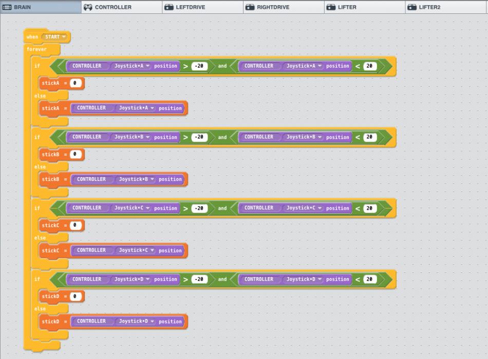

Yes, our teams will program the Autonomous AND the Driver Control in the same single program (this allows common sub-routines to be used by both Driver & Auton). This allows for development of both sets of code at the same time. Then, right before tournaments the teams have to make a second copy of the program to remove the controller, so that it can be used it for Auton Skills with the controller off (fine print rule in <PSC2>). Below is an example of “dead zones” programmed for the controller n Modkit, and the motor program that sets the speed to either the StickA variable or the AutoLeft variable based on a AutoControl “flag” variable, this allows that flag to switch from driver control to auton, then the AutoLeft (and a similar AutoRight) is used to set what speed the motors will go.
