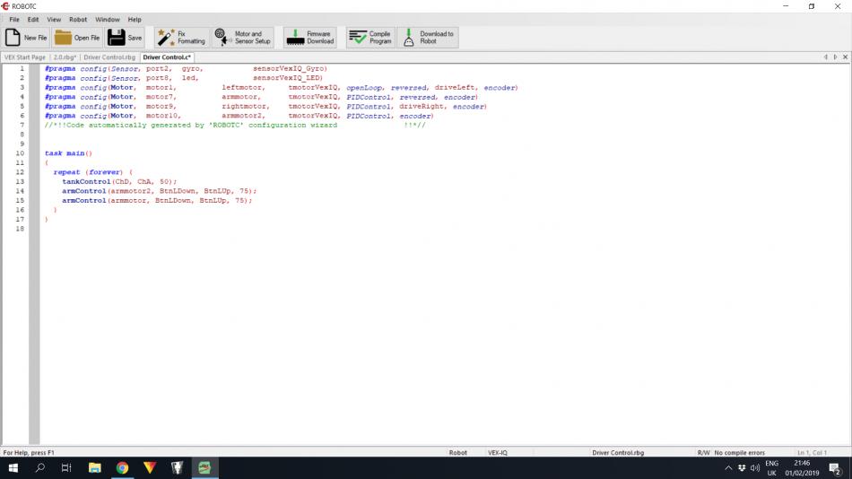

Does anyone know how to programme ‘states’? This is when you press either the small E or F buttons on the controller and the brain will turn a motor a specific amount. Very useful if you want to raise or lower an arm to an exact position. Thanks

We use robotC graphical. Thanks
If you are using the graphical version it would be difficult to do what you’re asking. However, this can be done fairly easily with regular RobotC, as shown by DaddyCrusader. He takes advantage of multitasking. See his code. The task armmovement() does what you want. It is called from task main() as shown.
If you like, you can write the non-task code in Graphical then convert the file to text. Under View|Convert Graphical File to Text. Once done a new file appears with a different extension (“.c*”). It can also be compiled and downloaded to the robot after you have added in the desire task code. You can’t go backwards to the Graphical version from here, but the original Graphical file is unchanged.

Thank you. I have converted the file below. Where does daddycrusader’s code go?
His code can be copied just above “task main()”
See his code under task main() to find out how to call his armMovement task. Your other commands in the repeatForever loop should remain after the startTask(armMovement) command.
