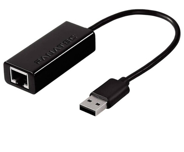

Would something like this work for programming?
It is serial not ethernet.
