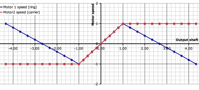

  2. Create a CVT style of control. Based on the formula we came up with in this thread, a graph of output speed vs the two motor speeds is as follows. (this graph ignores the fact that due to gearing one motor may in fact already be reversed)
[ATTACH]5911[/ATTACH]
For speeds below the maximum torque mode speed the drive can remain in torque mode, as more speed is needed start to reverse the direction of the ring gear motor (the chain on the Taiwan drive) to give additional speed.
This is free running speed and does not take into account additional speed loss due to load on the driven wheel, however, it is a good starting point.

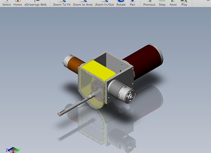

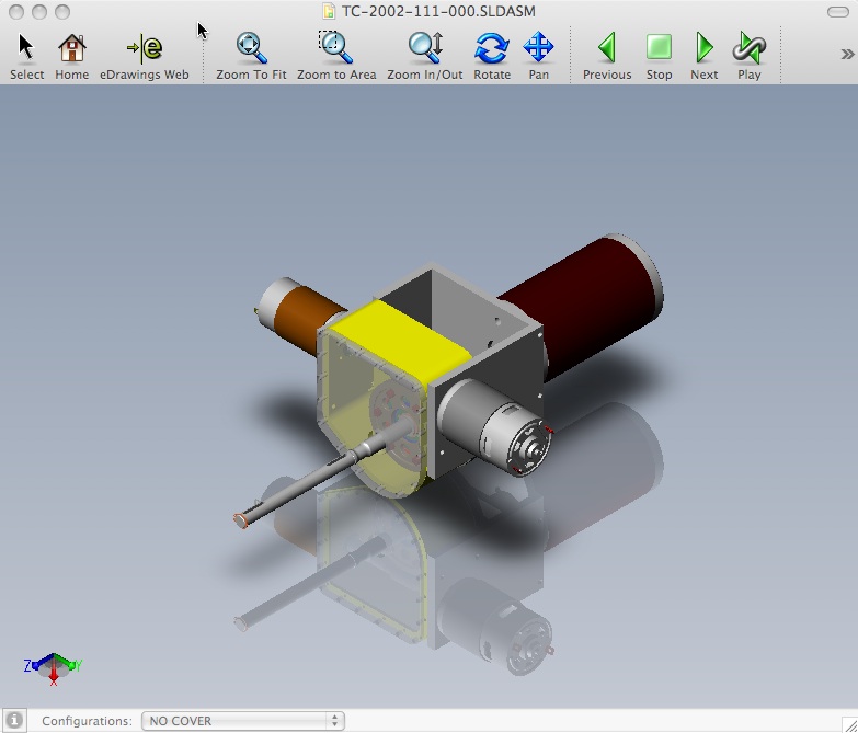

Upon attempt to import the SolidWorks files into Autodesk Inventor to get a 3D view of the mechanism, I encountered errors. What version of SolidWorks was used to create these models? I am using Inventor Professional 2012. I have an installation of Inventor Professional 2013 installed at home, which I will attempt to use later, but I would like to know what version these models are to know beforehand if it is simply a version issue or simply won’t work, period.
Thanks!
I think it was SW 2002. There should also be STEP files that should work. I will try to bring them in to a newer version of SW and export to Inventor.
I actually noticed the STEP file today, which opened fine in Inventor, though there were no physical gear teeth in the file. Do the SW files’ gears have textured teeth that would export differently to Inventor? If it doesn’t work out, then the STEP file would work just as well.
Thanks!
(sorry for getting a bit off-topic, jpearman)
For those who just want to view Paul’s design, you can open the solidworks assembly in eDrawings, a free 3D viewer for PC, Mac and iPad.
[ATTACH]5914[/ATTACH]
