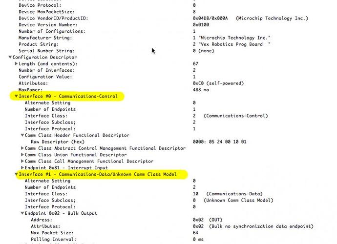

I highlighted one part which is key to understanding why the USB programming cable works under OSX and the cortex does not. Using an OSX developer utility called USBProber we can have a look at the USB device descriptors.
Here is the output when using the programming cable.
and the cortex
Notice that the programming cable implements the two interfaces required by the spec whereas the cortex does not.
Windows is less picky about this than OSX which is why everything works correctly there. OSX starts two separate drivers, one for the control interface and one for the data interface, this doesn’t work with the cortex as two drivers cannot open the same interface. I have written some application code in the past that does talk to the cortex over USB, the actual data exchange is still sort of CDC compliant, the same messages are sent so there is hope for a simple driver.

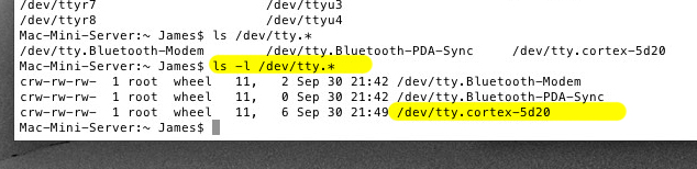

So I found this poor Mac guy dying on the street and he said “please write a driver for OSX” so I did.
Version 0.9 is done, serial communication using the USB A-A cable direct to the cortex under Snow Leopard. It needs some more tweaking and testing under 10.7 and 10.8 but it seems to work. The driver only loads when it detects the cortex, the standard Apple CDC ACM driver is used for the programming cable, I need to make sure everything is playing nicely together so will not release for a few days.
Shows under /dev as another tty port, didn’t decide on the final naming yet.

I’ve tested as much as I can today, works with Leopard (different installer) through Mountain Lion.
I changed the name of the serial device back to /dev/tty.usbmodemxxxx (where xxxx will be a unique number that depends on which USB port you plug into) so as to be compatible with the PROS flash utility. I preferred the /dev/tty.cortex name but PROS would not detect that as a suitable serial port so usbmodem (which is Mac default) it is. It also works with the stm32flash open source utility I released last year but the PROS utility seems more stable.
