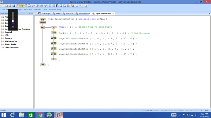

so i have a v4 cortex and i am doing tower takeover i have a 4 motor 4 wheel chassis and i used a tank 4 motor on easyc and my robot keeps spinning in circles then i need two motors for the arms can anyone help me with my programming, or give me a sample one to try my competition is march 27th and i don’t have a lot of time
that is the program in easyC v5 cortex
Could you post your code so we can see what is wrong. Also you need to make sure to check if certain motors are reversed or not.
You need to reverse one side of the robot. Because the motors are mirroring each other, you need to reverse one side. Do this either in motor/sensor setup, or add a - before the command to power one side of the robot.

I think she needs to know how to program 2 motors that are on her robot’s arms. I think she needs help, because the code is different then tank drive.

yes the arm is already built i need to tie it into the programming

ok thank you and my chassis motors are in ports 2-6 and the arm and claw are in 7 and 8

4 chassis motors 2,3,4,5, yes sorry and 6 and 7 for the claw and arm and i will switch to robot c and try it
Are 2 and 3 the Right side, Left side, Front side, or Back side? Claw is 6, Arms are 7 and 8?
2,3 left 4,5 are the right ones 6 is the claw open and close and 7 is the arm up and down
