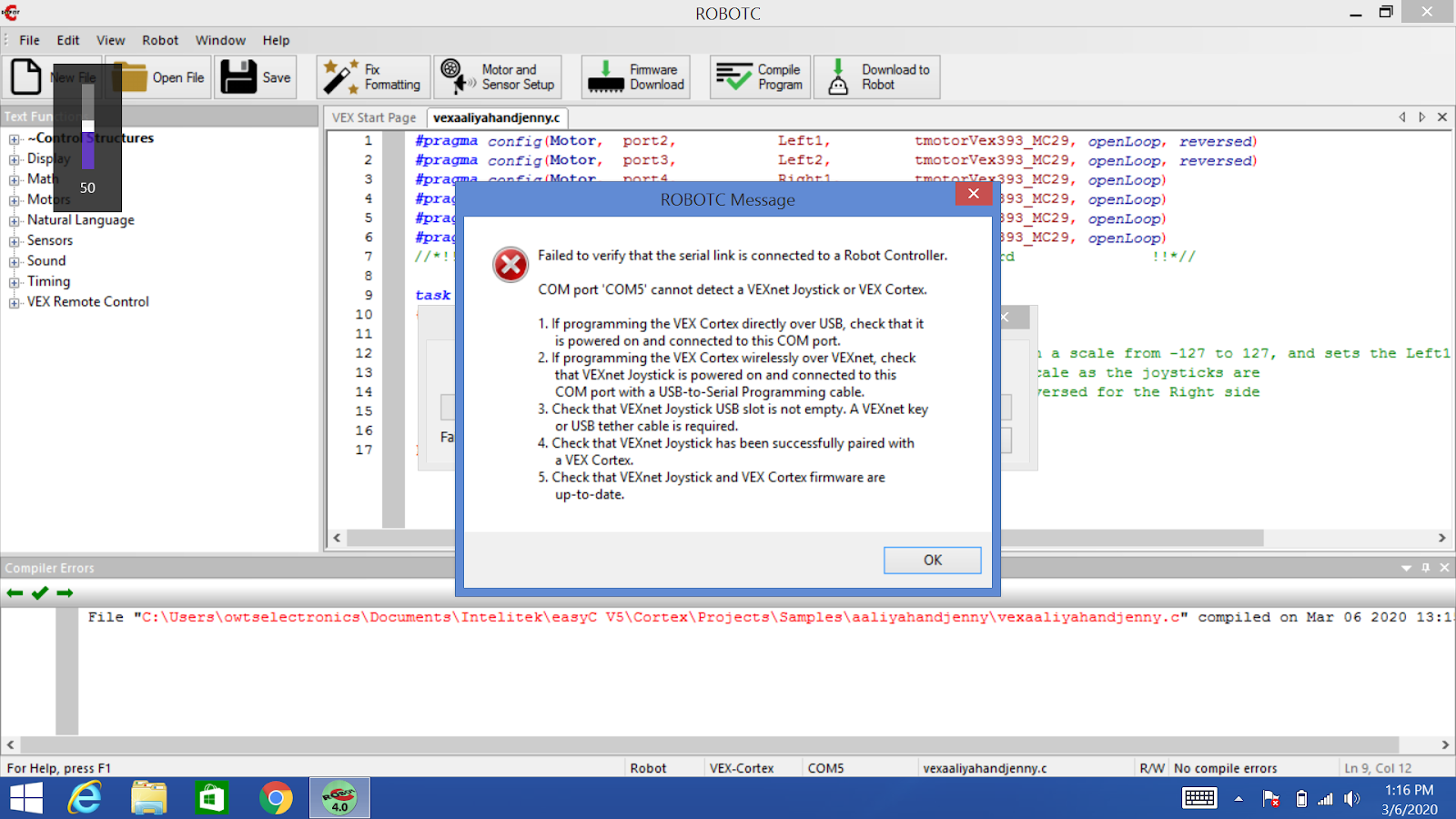

i am receiving an error message when trying to download my program to the robot any suggestions
Could you post screenshots from your computer and pictures of your robot/download cable attached to it?
that is the error message

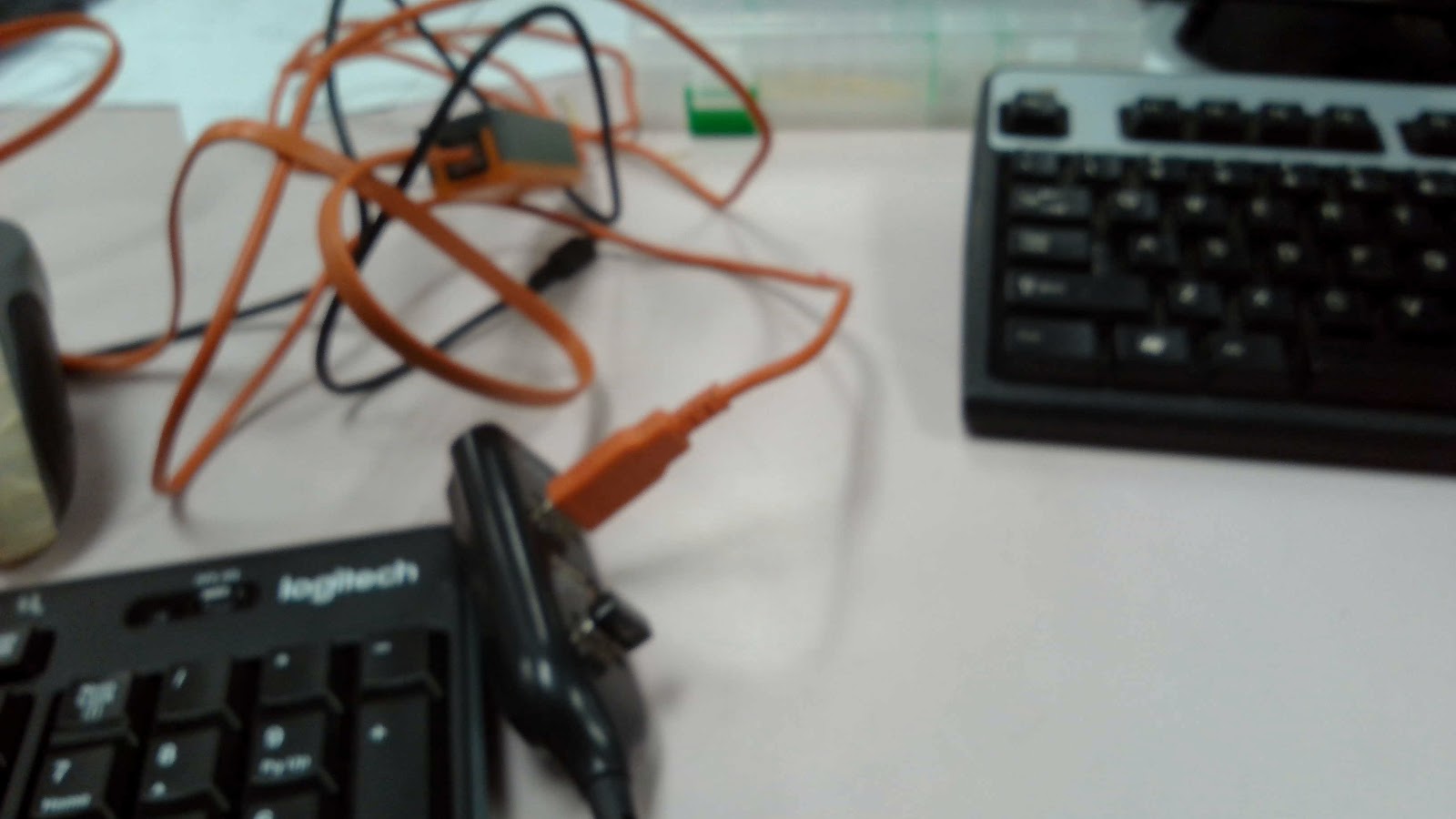

that is it connected to the computer

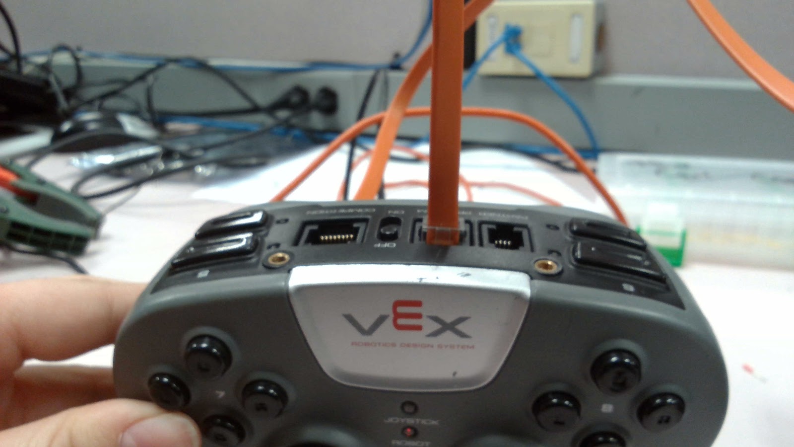

Could you show a picture of the cable plugged into the controller/brain?
connected to the controller this is how i was told to do it one that part in the controller and the USB end into the computer

First follow the instructions on the error message, then:
I would recommend you to change the usb to a usb slot that the computer has, not a mere extension cord. Second of all make sure that the USB is plugged into the orange adapter and its snugly in place. If both doesnt work, click “firmware download” on the top of the tab and see if that will connect and reinstall the firmware as it may be a firmware issue.
What’s the number of the COM port it’s installing itself as in Windows? i.e. COM1, COM8, etc.?
com port 5
i believe
I agree with Connor. Definitely use the actual USB port on your computer, not a USB hub.
