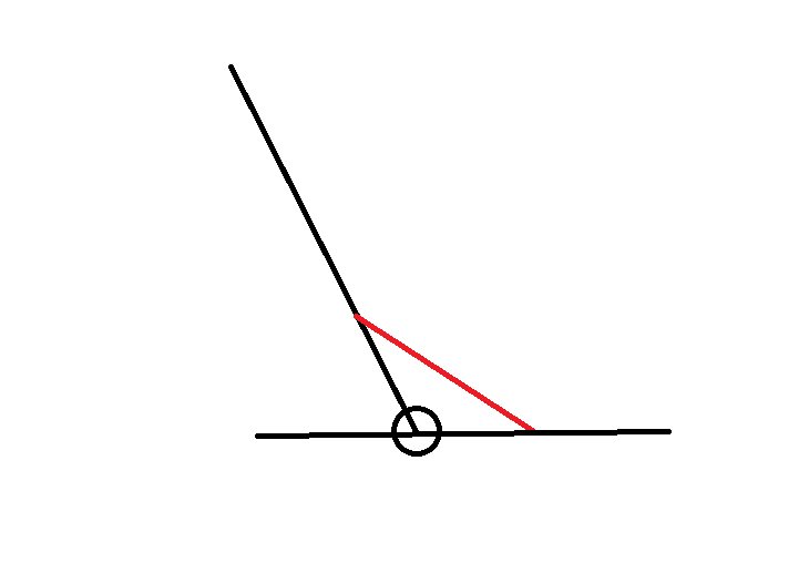

For our tray tilter.
You cannot just increase strength, it would require energy, once a rubber band has unstretched it released all its energy. You can however use them for counteracting gravity.
Awesome, thanks. So we should change the gear ratio rather than add rubber bands?
Ok you would probably want rubber banding to pull the tray up. Sort of like a 2 bar system. image The red line is the rubber band.
Compared to motor without rubber bands, the system has a greater energy capacity. The motor does work to stretch the rubber band, thus storing energy in it to increase force when it runs in the other direction.
Thus, when working against gravity (e.g. a lift, tilter, etc.) one uses rubber bands to dampen a portion of the gravitational force, as it is acting in the opposite direction of your desired travel only when you are “lifting” upwards (against gravity).
